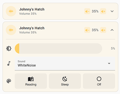

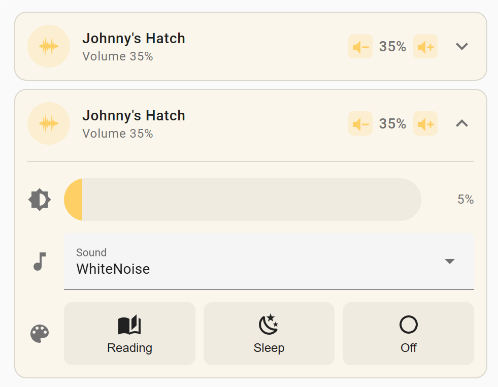

A full-featured control center with one-touch scenes for your bedtime routine:

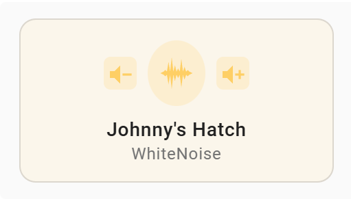

Or a compact, minimalist version for your mobile dashboard:

  • Powerful Scene Control: Create one-touch presets to set the perfect mood. Activate a Home Assistant scene or define custom light and sound settings directly in the card—even turn devices off.
  • Two Layouts: Choose between a compact vertical or a detailed horizontal layout.
  • Dynamic Backgrounds: Set the card background to reflect the light’s color or visually represent the volume level.
  • Powerful Sleep Timer: Create timers with custom presets and define actions upon expiration (like an “OK-to-Wake” clock!).
  • Highly Customizable: Toggle visibility for every control to create your perfect interface.
  • Easy Configuration: Fully configurable through the Lovelace visual UI editor.

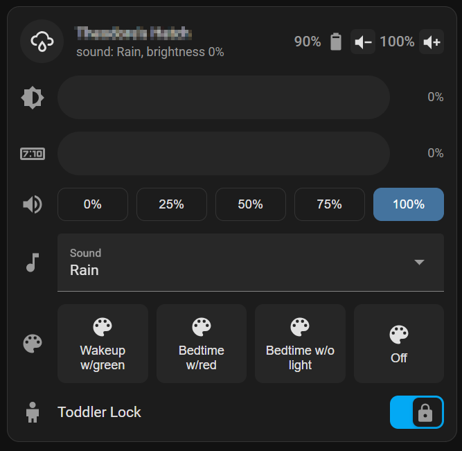

Here’s a snapshot of my current setup:
type: custom:hatch-card
light_entity: light.name_light
media_player_entity: media_player.name_media_player
show_sound_control: true
show_brightness_control: true
show_timer: false
show_scenes: true
scenes:
  - entity_id: scene.wakeup_w_green_2
  - name: Bedtime w/red
    entity_id: scene.bedtime_w_red_2
  - name: Bedtime w/o light
    entity_id: scene.bedtime_w_o_light_2
  - name: "Off"
    turn_off_light: true
    turn_off_media: true
timer_action_turn_off_media: false
timer_action_turn_off_light: false
secondary_info: "sound: {sound}, brightness {brightness}%"
volume_presets:
  - 0
  - 0.25
  - 0.5
  - 0.75
  - 1
show_brightness_when_off: true
show_toddler_lock: true
show_clock_brightness: true
show_battery_indicator: true
toddler_lock_entity: switch.name_toddler_lock
clock_brightness_entity: light.name_clock
battery_level_entity: sensor.name_battery
charging_status_entity: sensor.my_rest_2nd_gen_battery
