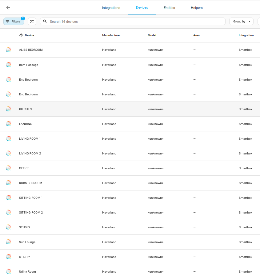

Success!! It worked, thank you. The only issue is that it shows several radiators that I don’t have (see images). I have 4 radiators but the list shows 16! The 12 that I don’t have are not connected (which is just as well) so I will just disable them. I wonder if Haverland includes these as defaults/tests. They don’t appear in the Haverland app. Anyway, thank you so much for getting this working - great work.
