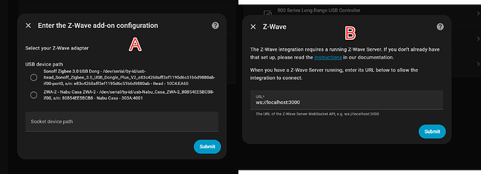

that is compacted view
Ok duh, I had made my window smaller and it “compacted”
So I have A and B as options
B give me an error each time I try to use it, and I thought I read somewhere not to add the other hub via the dongle, so I was scared to try it, i didn’t want to break anything.
Specifically this part
* In the next dialog it will ask for the server. Enter: `ws://a0d7b954-zwavejs2mqtt:3000`
* Confirm and done!
sorry, for some reason I thought it showed that as default.
use Option B from your image

I click add hub, select custom install, uncheck the box, and put in the ws://a0d7b954-zwavejs2mqtt:3000 or the garage IP ws://10.0.0.188:3000, and it will switch back and forth, each time giving me the message of “device already configured.” I click ok and it then only shows which ever address i picked that time.
