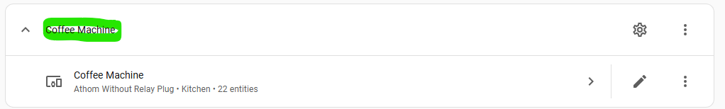

In ESPHOME gui - I renamed the athom_without_relay_plug_f26ff4 to say ‘Coffee Machine’ like below by clicking the three dots and rename -
That did not do it, so I clicked into it and tried rename entitiy ID’s, and ‘IDs will not change’.

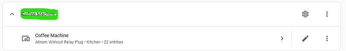

So to ‘took ownership’ (I think that was the term) in esphome addon of the one that is the coffee machine, then gave it a name of coffee machine instead of smart plug f26ff4. It did some compiling I think - as it would not let me move forward. I then edited its config with the one from athomtech, modded that for the name and friendly name, plus my wifi section, left the encryption key, and compiled that and installed it wirelessly to the device.
The name it has now on the website for itself is ‘coffee machine f26ff4’ - which is a step in the right direction at least for identifying these in automations.
So I allowed it to be added to the esphome integration, then keyed in its encryption key, and it added - but with the stupid horrible identityID again - but this time, when I renamed id’s, it allowed me to rename them all!
