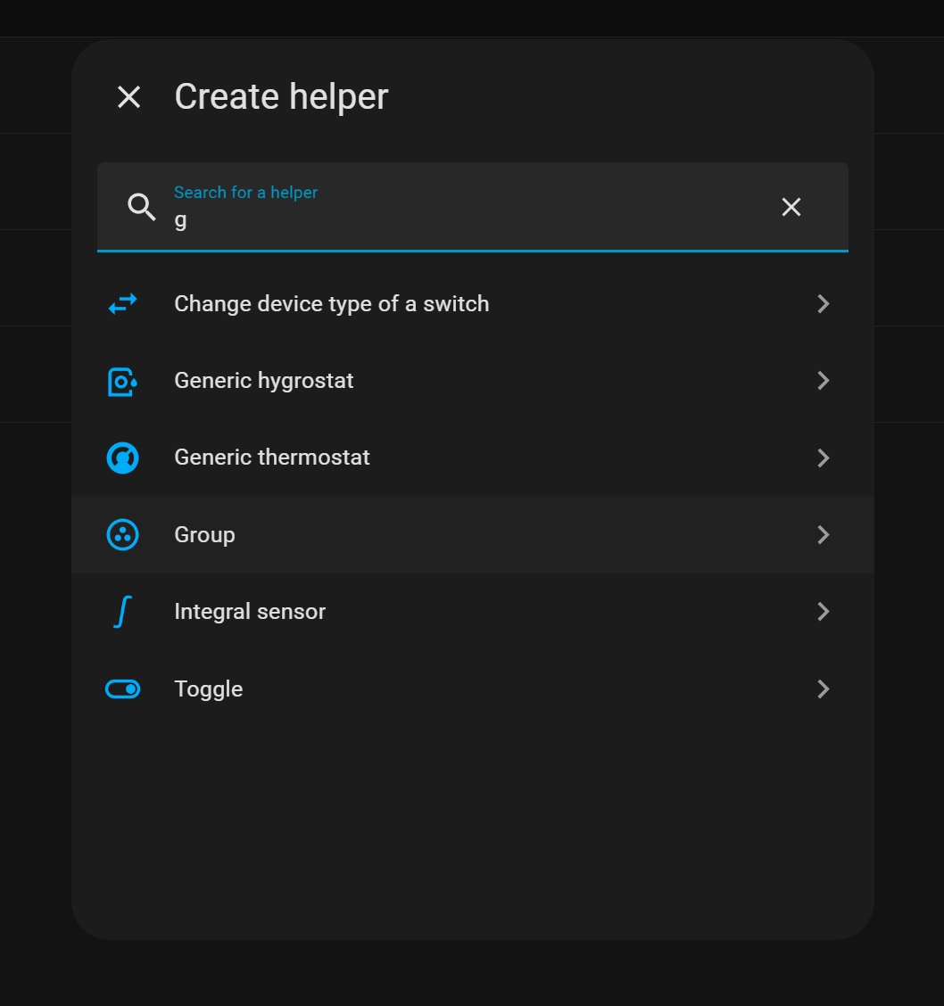

Okay, here’s what I’m doing…

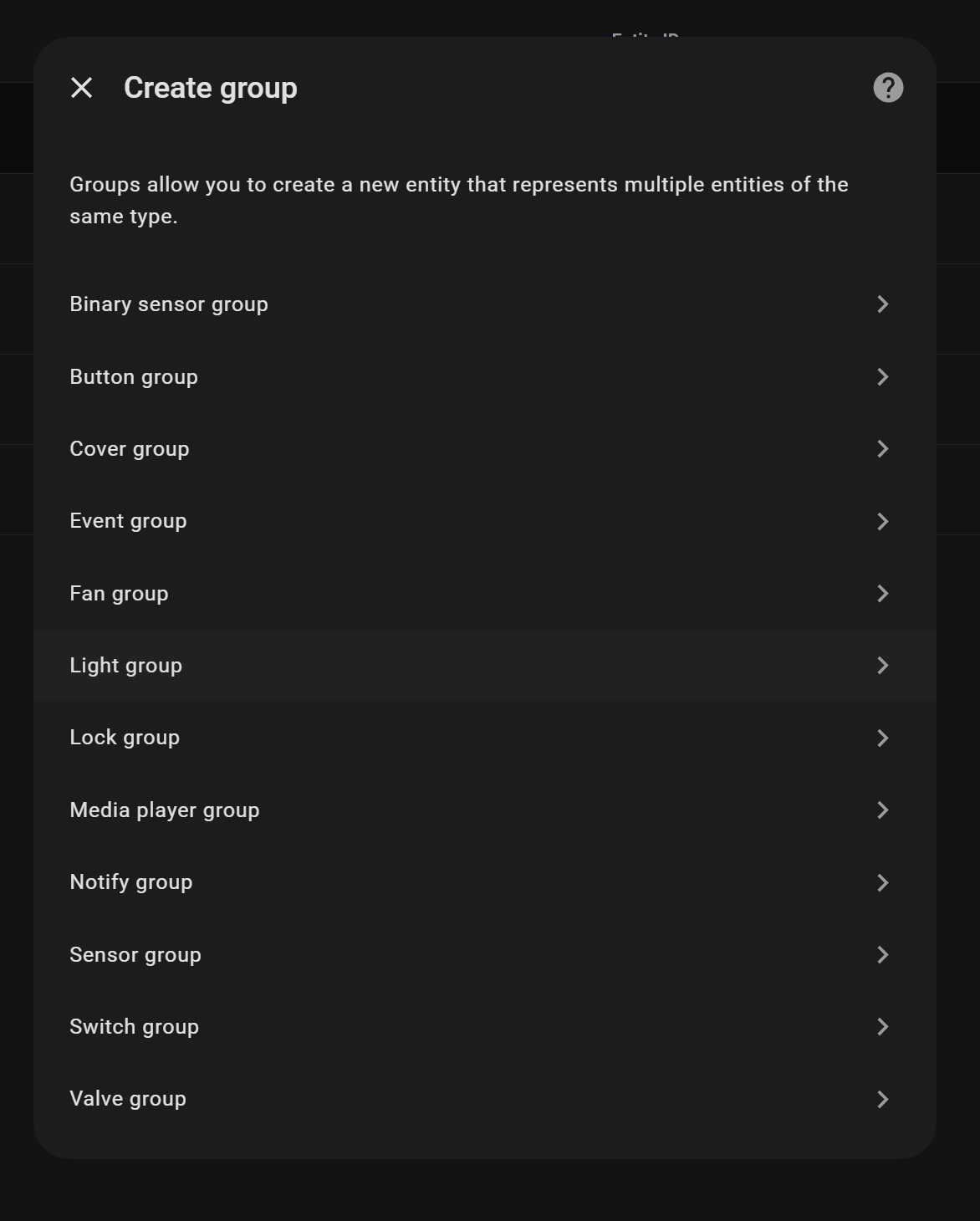

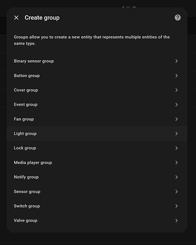

Create Helper → Group
Light Group

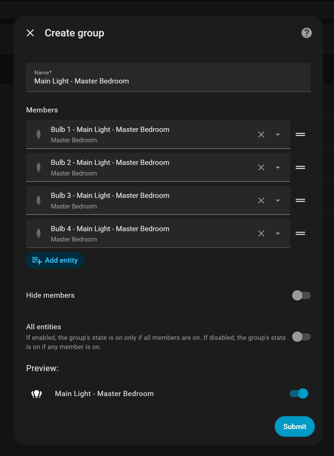

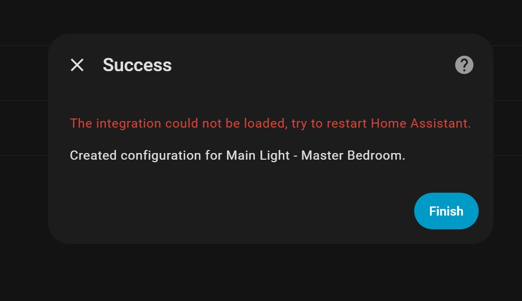

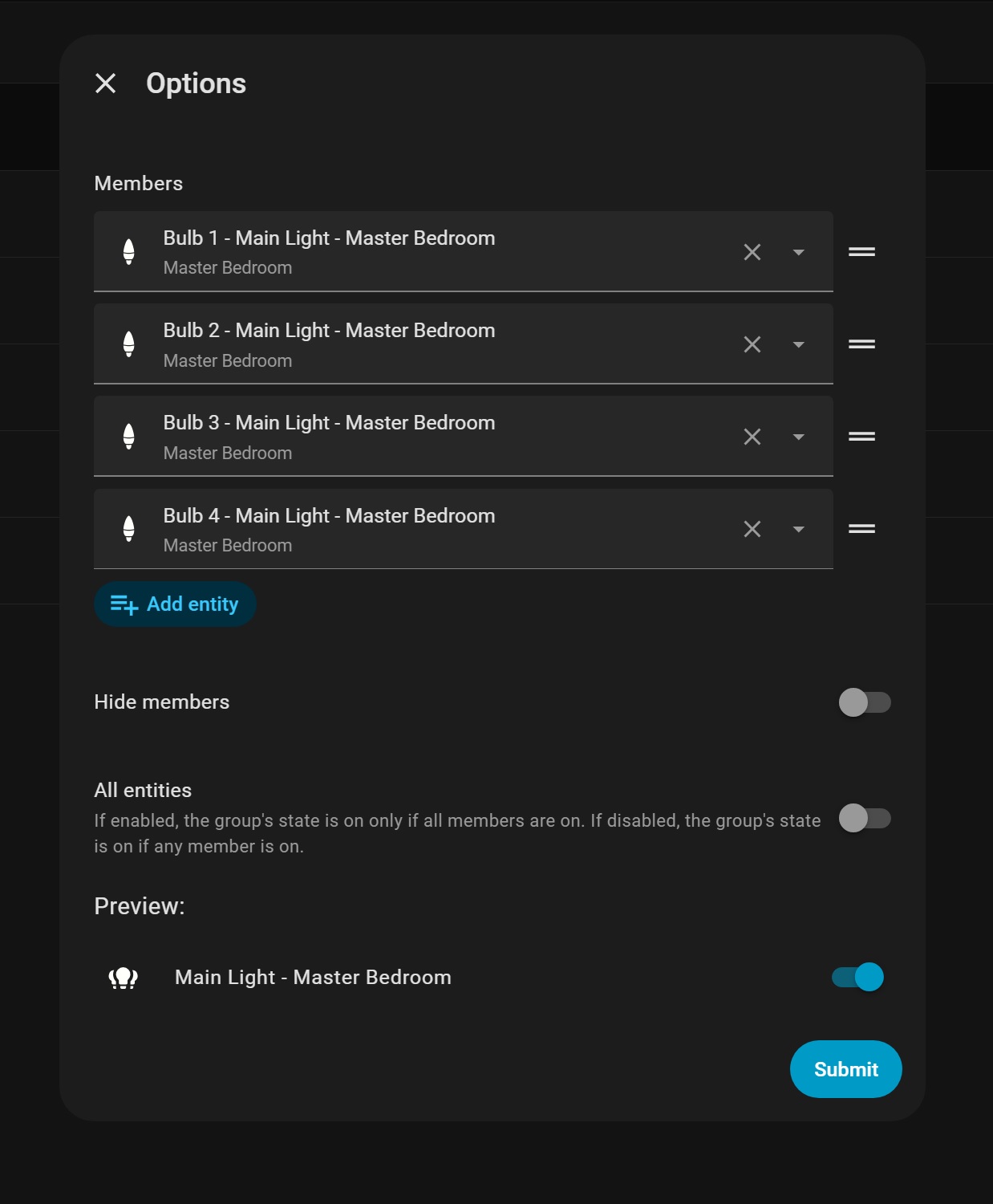

I want to add all the WLED bulbs in my overhead light.
After hitting submit, here’s what I have.

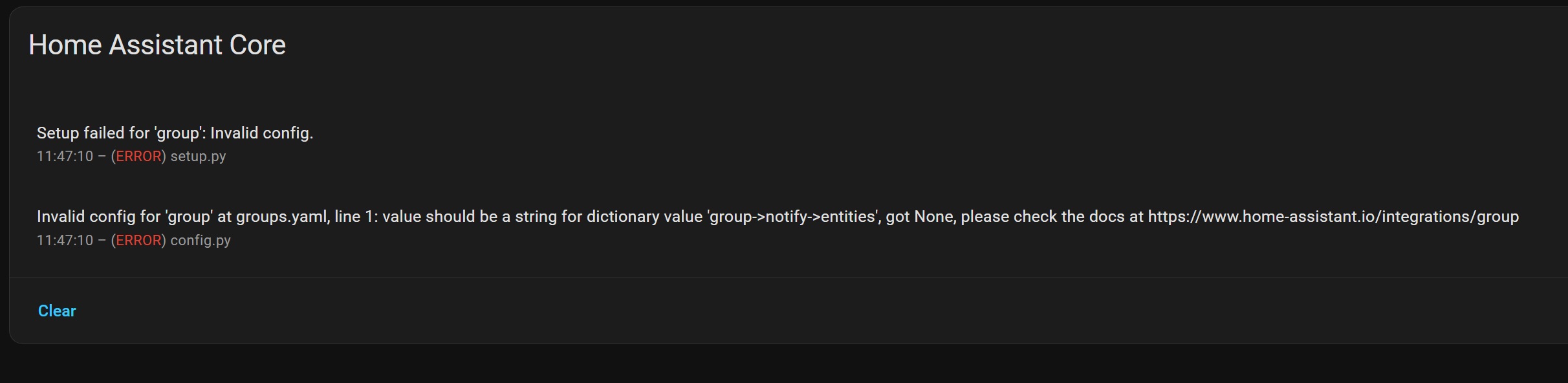

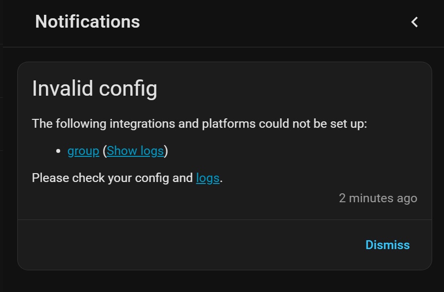

I restart HA and get this error.

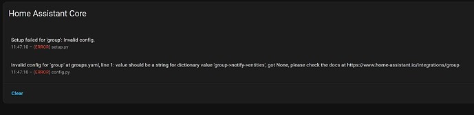

Here’s what the logs say…

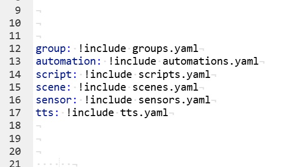

I have this in my main config.yaml file

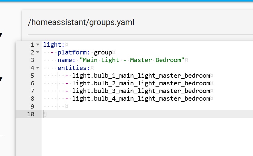

I do have a groups file but it’s empty.
I went ahead and manually added the entities to the groups file but it doesn’t seem to be doing anything.
You don’t need to create that entry in your configuration.yaml, that’s the old way and since you are doing it through the UI…

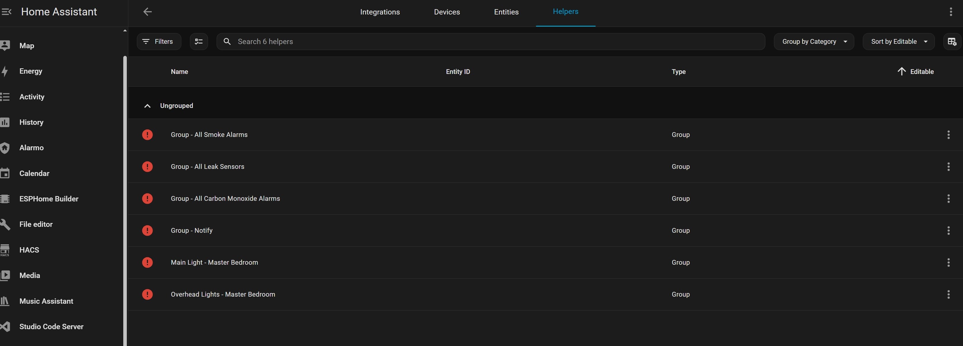

When I click on the group, I get this.

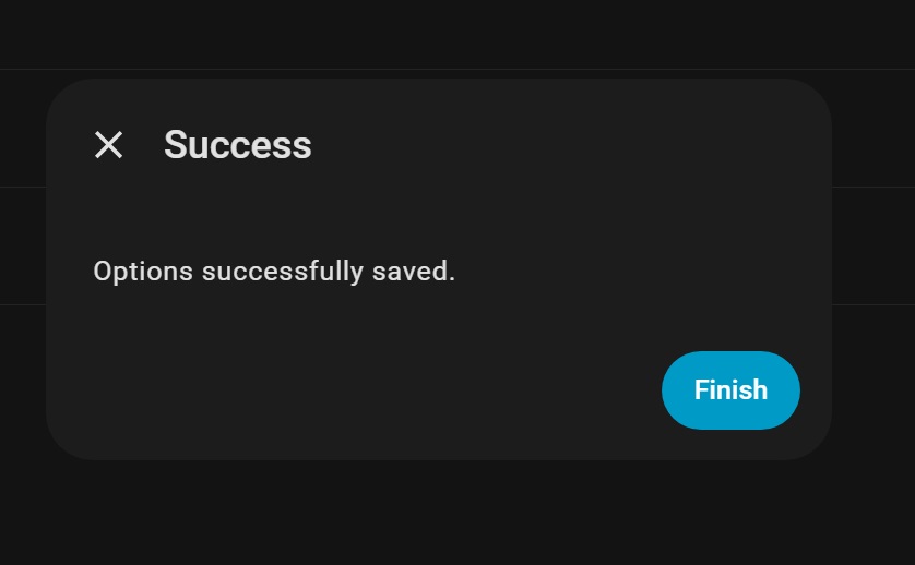

I can submit it and it looks like it worked.
But I have no group entity. I also can not delete the group.
It complains about a notifier group, could you have a line somewhere using packages, with a groups.yaml in another folder too? Or any other place defining a notifier group? It seems like your yaml files contain errors.
Very possible. What’s the best way to go about searching for that?

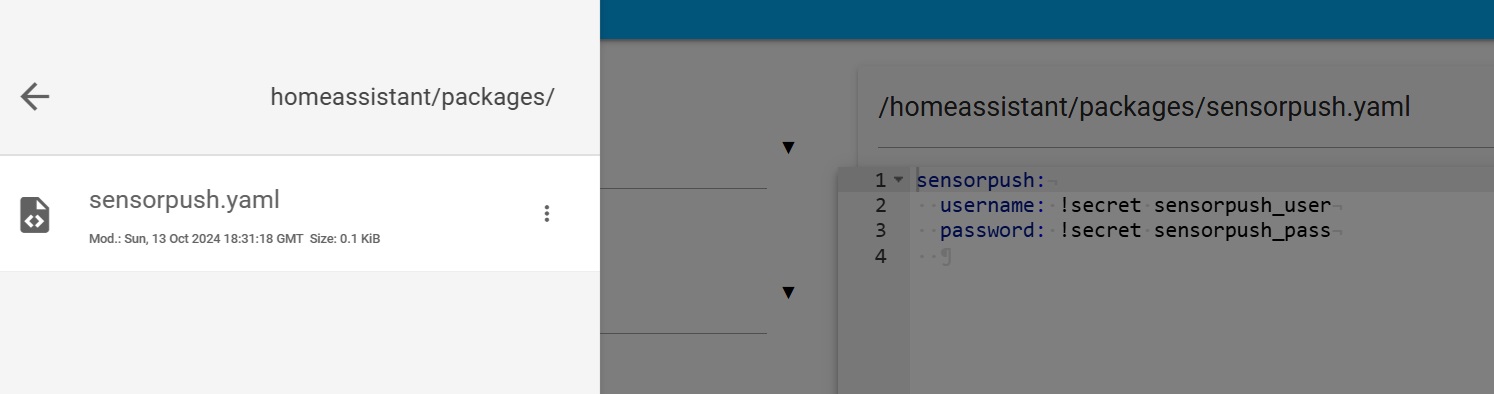

Is there a line mentioning packages in configuration yaml? That might refer to a folder where more files are.

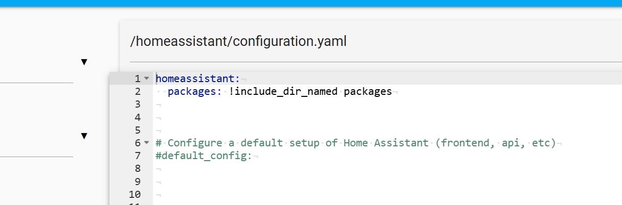

Here’s what I have in my config file
Here’s the only thing I have in my packages file…
I see you commented out default_config in configuration.yaml? Then you are in charge of adding all default integrations. Why did you remove that line? I’m not sure what consequences that has. I have no experience with that.
I think that’s it! I don’t know why it was commented out. But undoing that and restarting seems to be the answer! I now have a light group that I can control!
