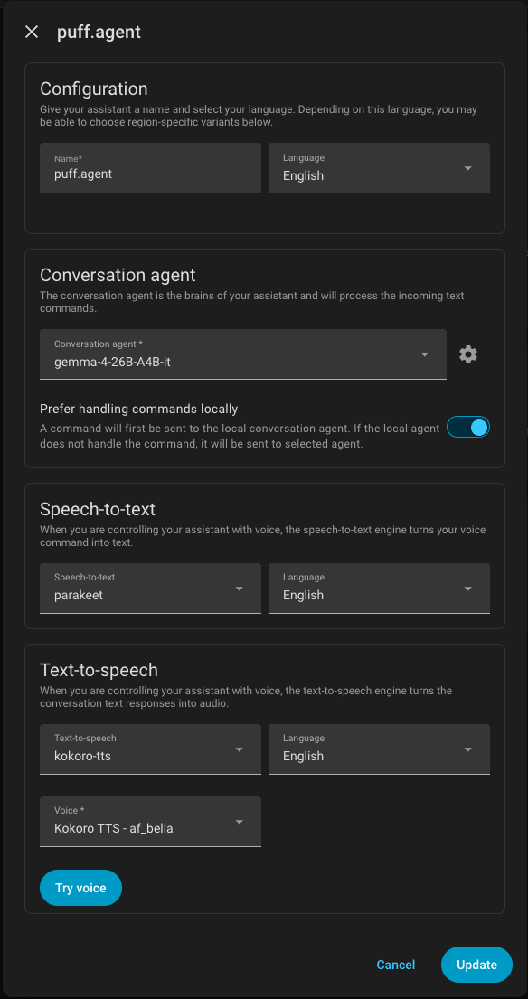

Here's my current pipeline config:
And below is a full recent run where the detected audio was: "Set the timer for six minutes." but it still didn't handle it locally and sent it to the LLM to handle :thinking:
Full run output
stage: done
run:
  pipeline: 01gzkzge0e2q66aj1cxxccbwfn
  language: en
  conversation_id: 01KT990N52KT5Q0E9546MN4ZA1
  satellite_id: assist_satellite.home_assistant_voice_090de2_assist_satellite
  tts_output:
    token: LgIH8BuVRWGIkxoY7r21sQ.flac
    url: /api/tts_proxy/LgIH8BuVRWGIkxoY7r21sQ.flac
    mime_type: audio/flac
    stream_response: false
events:
  - type: run-start
      language: en
      tts_output:
    timestamp: "2026-06-04T12:17:20.498912+00:00"
  - type: stt-start
      engine: stt.parakeet
      metadata:
        language: en
        format: wav
        codec: pcm
        bit_rate: 16
        sample_rate: 16000
        channel: 1
      audio_processing:
        requires_external_vad: true
        prefers_auto_gain_enabled: true
        prefers_noise_reduction_enabled: true
    timestamp: "2026-06-04T12:17:20.499283+00:00"
  - type: stt-vad-start
      timestamp: 9340
    timestamp: "2026-06-04T12:17:29.842232+00:00"
  - type: stt-vad-end
      timestamp: 12240
    timestamp: "2026-06-04T12:17:32.720955+00:00"
  - type: stt-end
      stt_output:
        text: Set the timer for six minutes.
    timestamp: "2026-06-04T12:17:33.233033+00:00"
  - type: intent-start
      engine: conversation.gemma_4_26b_a4b_it_2
      language: en
      intent_input: Set the timer for six minutes.
      device_id: 93fa98ff09e8db20d49e6f20e303d181
      prefer_local_intents: true
    timestamp: "2026-06-04T12:17:33.233332+00:00"
  - type: intent-progress
      chat_log_delta:
        role: assistant
    timestamp: "2026-06-04T12:17:40.495913+00:00"
      chat_log_delta:
        content: I
    timestamp: "2026-06-04T12:17:40.496055+00:00"
      chat_log_delta:
        content: "'"
    timestamp: "2026-06-04T12:17:40.519532+00:00"
      chat_log_delta:
        content: m
    timestamp: "2026-06-04T12:17:40.545116+00:00"
      chat_log_delta:
        content: " sorry"
    timestamp: "2026-06-04T12:17:40.571044+00:00"
      chat_log_delta:
        content: ","
    timestamp: "2026-06-04T12:17:40.597340+00:00"
      chat_log_delta:
        content: " but"
    timestamp: "2026-06-04T12:17:40.623314+00:00"
      chat_log_delta:
        content: " I"
    timestamp: "2026-06-04T12:17:40.649483+00:00"
      chat_log_delta:
        content: " don"
    timestamp: "2026-06-04T12:17:40.675779+00:00"
      chat_log_delta:
        content: "'"
    timestamp: "2026-06-04T12:17:40.701239+00:00"
      chat_log_delta:
        content: t
    timestamp: "2026-06-04T12:17:40.727769+00:00"
      chat_log_delta:
        content: " have"
    timestamp: "2026-06-04T12:17:40.753475+00:00"
      chat_log_delta:
        content: " the"
    timestamp: "2026-06-04T12:17:40.779608+00:00"
      chat_log_delta:
        content: " ability"
    timestamp: "2026-06-04T12:17:40.805872+00:00"
      chat_log_delta:
        content: " to"
    timestamp: "2026-06-04T12:17:40.832004+00:00"
      chat_log_delta:
        content: " set"
    timestamp: "2026-06-04T12:17:40.858085+00:00"
      chat_log_delta:
        content: " timers"
    timestamp: "2026-06-04T12:17:40.884337+00:00"
      chat_log_delta:
        content: .
    timestamp: "2026-06-04T12:17:40.910653+00:00"
  - type: intent-end
      processed_locally: false
      intent_output:
        response:
          speech:
            plain:
              speech: I'm sorry, but I don't have the ability to set timers.
              extra_data: null
          card: {}
          language: en
          response_type: action_done
            success: []
            failed: []
        continue_conversation: false
    timestamp: "2026-06-04T12:17:40.937470+00:00"
  - type: tts-start
      engine: tts.kokoro_tts
      language: en
      voice: null
      tts_input: I'm sorry, but I don't have the ability to set timers.
      acknowledge_override: false
    timestamp: "2026-06-04T12:17:40.937622+00:00"
  - type: tts-end
      tts_output:
        media_id: media-source://tts/-stream-/LgIH8BuVRWGIkxoY7r21sQ.flac
    timestamp: "2026-06-04T12:17:40.939080+00:00"
  - type: run-end
    data: null
    timestamp: "2026-06-04T12:17:40.939277+00:00"
started: 2026-06-04T12:17:20.498Z
stt:
  metadata:
    language: en
    format: wav
    codec: pcm
    bit_rate: 16
    sample_rate: 16000
    channel: 1
  audio_processing:
  done: true
  stt_output:
intent:
  language: en
  done: true
  intent_output:
    response:
      speech:
        plain:
          extra_data: null
      card: {}
      language: en
        success: []
        failed: []
tts:
  language: en
  voice: null
  done: true
  tts_output:
finished: 2026-06-04T12:17:40.939Z
