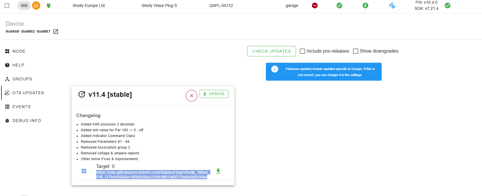

now this gets funnier. Seems I have the same device in my network (while figuring out where OTA could be triggered for you).
in ZWAVEJSUI
points to FW at
but fhe file name suggests a LR device.

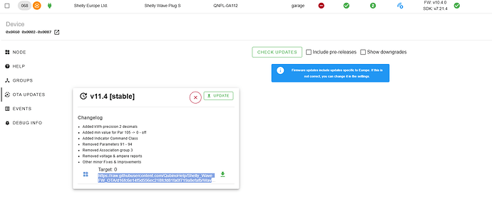

I went bold and pressed update:
and it finally succeeded:
you have a option to use zwave JSUI?
I just moved to the JS UI, and I’m getting the same as you. The tricky bit I find, is that this firmware is nowhere to be found on Shelly’s website. Was trying to look there, for they might specify which range of devices this update is applicable to.

But, after trying it anway just like you did, no success:
And just to confirm:
Back where it started.

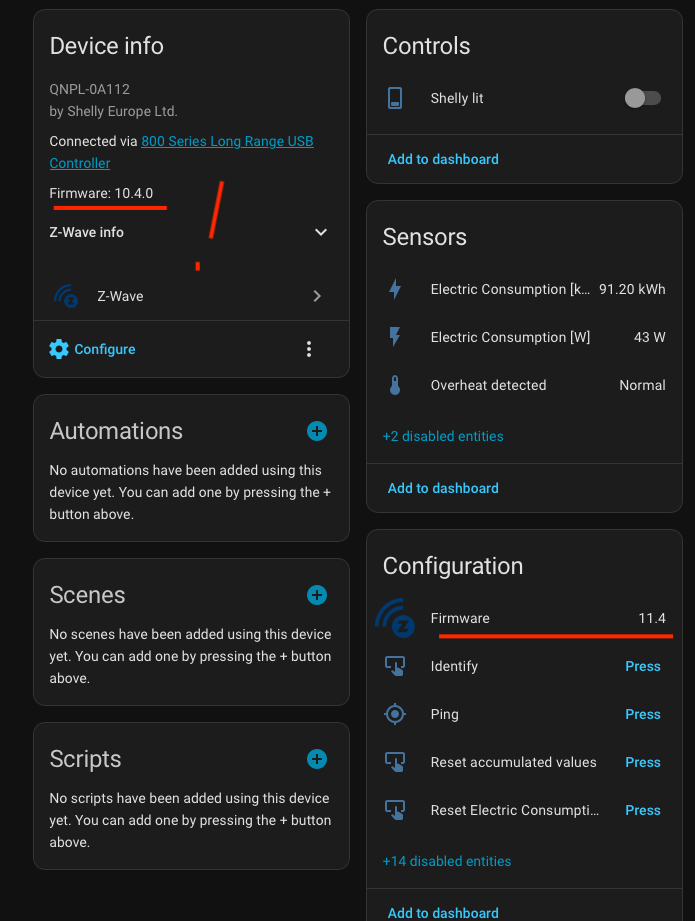

I have just been struggling with these plugs too though I have the feeling there is some bug. I found the firmware online for my EU version and applied that one manually (slow). After update it says failed (something of mismatch of hardware and firmware).
But when I open the details I see this. Not sure what is what and the plugs still are to be updated according the HA.
in that case i would do a reinterview or look in JSUI for firmware reported. Curios what will happen in all cases
Thanks god I am not allone. I have two plug S EU. One went smooth and on the secound i have the same issue. Tried already manual update and the old “non LR named Version” from archive here: Shelly_Wave_FW_OTA/Wave_Plug_S at main · QubinoHelp/Shelly_Wave_FW_OTA · GitHub
The firmware entity is a bit confusing. It should either say “up-to-date” or display the version that it can update to. So your screenshot is correct in saying “Firmware: 11.4” - it just means there’s an update available to 11.4.
