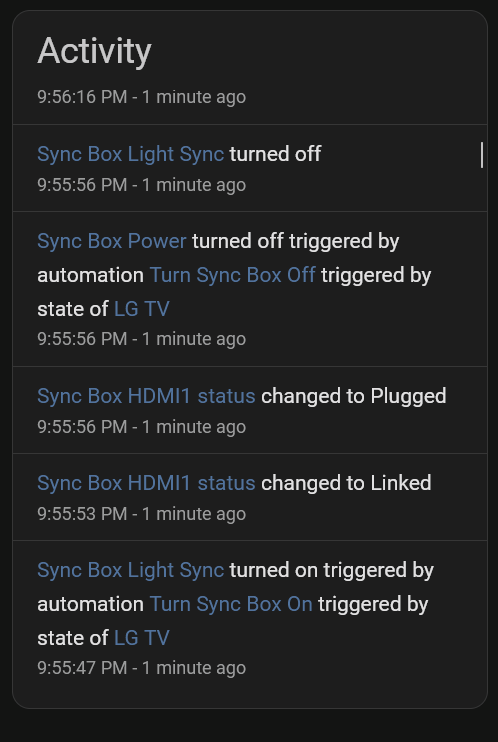

Check the Activity panel (in the left hand menu). Was there any context given for turning off your philips hue sync box?

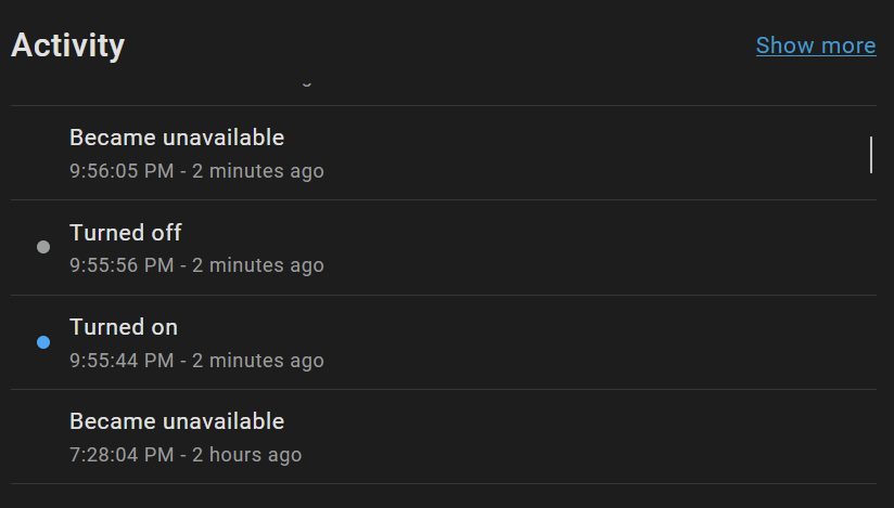

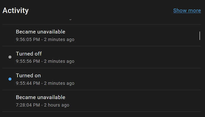

I’ve modified my script. I guess it was setup that way with the device ID’s because I used the visual editors.
So I just tested by removing my tv from the wifi connection and you can see the trigger activates, but it looks like for some reason the wifi disconnection is sending a “Turned off” followed by a “Became unavailable” about 10 seconds later. I did not turn off the TV at these times, just disconnected from the wifi.
You are not going to be able to filter that out. There is no way to tell if the TV turned off because you turned it off or because you disconnected the wifi.
You need to open an issue for whatever integration you are using to connect the TV to home assistant.
Yeah, unfortunate. I’ll have to see if I can tie this to something else. Maybe I can just check to make sure the tv has been off for x minutes before I shut off the sync box, that way momentary drops don’t trigger it.
