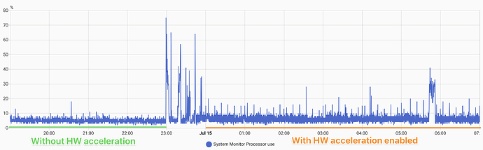

Yes CPU utilisation does seem to be notable. Mine goes from 2-4% with the HAVNC add-on stopped to around 32% with HAVNC started.
I have no camera feeds
mine usually remains below 10% but spikes to 44% at times. tuning the VNC instance to use a lower resolution might help.
Thanks all for the feedback, I’m really happy to see people are trying to use it.
I think the CPU utilisation is mostly from Chrome and all the javascript it runs but it’d be interesting to test if lowering the resolution would make a difference
I found a way to enable low power low-power mode which might reduce the load. The load from my dashboard on my pi4 is not high enough that I can see a difference. If someone want’s to try you will have to disable the kiosk mode on chrome and go to chrome://discards and toggle it there.
To disable the kiosk mode you can either remove the --kiosk from config/supervisor/5-chromium.conf and recompile. Or the faster way to test changes if you have enabled low level ssh debugging is to jump into the container with docker exec -ti addon_local_havnc /bin/bash , modify the file in /config/ directly and then send a kill -HUP to supervisor to make it restart chrome.
I also experimented with enabling hardware acceleration in Chrome, which was not enabled for me but it looks like it increased the cpu usage not decreased it. I believe I got that part working by apk add mesa-vulkan-broadcom inside the container but I’m not sure, have not tried to reproduce it. You can check if you have that working or not by going to chrome://gpu/ after you have disabled the kiosk mode.
