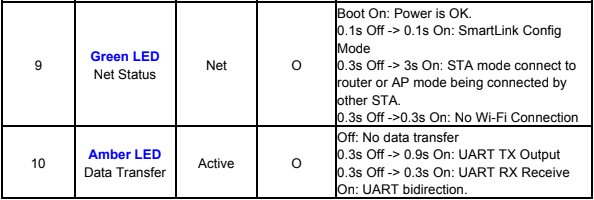

Also, my EW11 has been installed for 2 days now and both days when I check the status in the morning, it has gone offline (not on my Wi-Fi network and not broadcasting its own). Yesterday, I fixed this by unplugging and re-plugging the ethernet to RS-485 cable to reboot it and it started working again. Did I get a bad EW11 or is this a configuration mistake?
When it is in this error state, both the green and yellow LEDs are flashing every ~0.3s in unison.
When it is working, the yellow LED flashes 5 times while the green LED stays on, then they turn off together and the cycle repeats.
I read the manual here EW11 - Google Drive
Looks like mine may be on the edge of my Wi-Fi network and be getting disconnected when the conditions are right. I bet mounting the antenna outside the pool controller box will boost the signal enough to not have this issue.

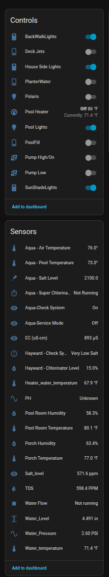

Adding a snapshot here of the available info from my pool controller. There are a lot more things on this device, but you can see all the Hayward stuff in the mix.
