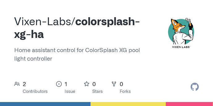

With Claude’s help, I reverse-engineered the BLE protocol (full protocol notes in the repo for those curious), and built an ESP32 bridge that holds the Bluetooth link to the controller and makes it accessible in Home Assistant over the ESPHome API. After refining it for several weeks, v1.0.0 went out today after a 5-day test with the Bluetooth link held continuously and zero errors logged. Repo here:
