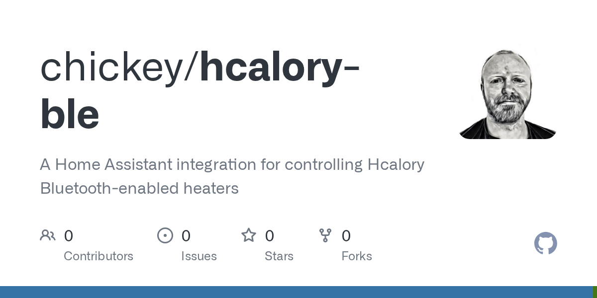

Thanks for building this ! I just installed the intergration but I have no success in getting this to work and see others in Github reporting issues too so wondering what the status is of this project.
I was able to install the integration but my Hcalory heater is not found even though I have a functional bluetooth proxy nearby (within 3 meter aka 9ft)
I checked the github page and I verified I have the same controller / display as @Badabinski further more I am running HA on the latest version aka 2025.9.1

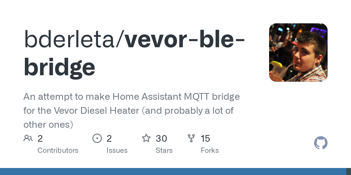

Hi man, you already know about this source?
they basically did the same thing you did. you might get some insights.

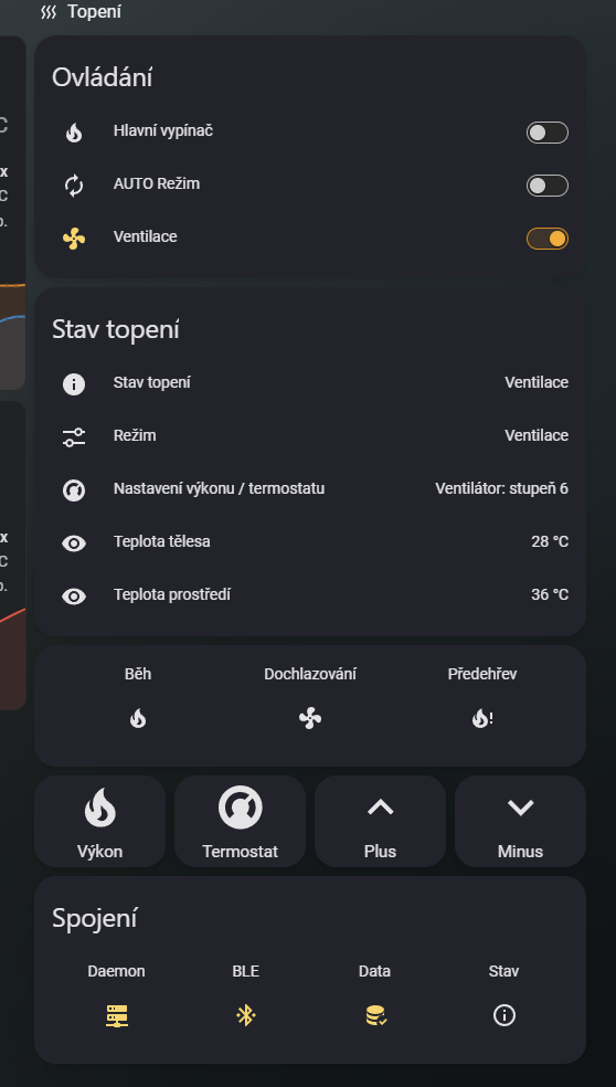

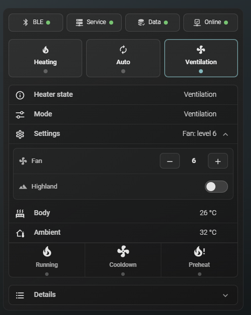

That was an attempt to fix it, but whole concept was bad since beginning so I ended with my own daemon based solution. I pushed it today. GitHub - davfiala/hcalory-ha-daemon: A Home Assistant daemon for controlling Hcalory Bluetooth-enabled heaters · GitHub
But this is just daemon, HACS integration to read from this daemon is coming soon.
HACS integration is also on Git, including premade Lovelace Card
Thanks I was able to get this installed. Haven’t tested out the controls, but it looks like it is pulling in the correct data.
