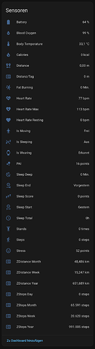

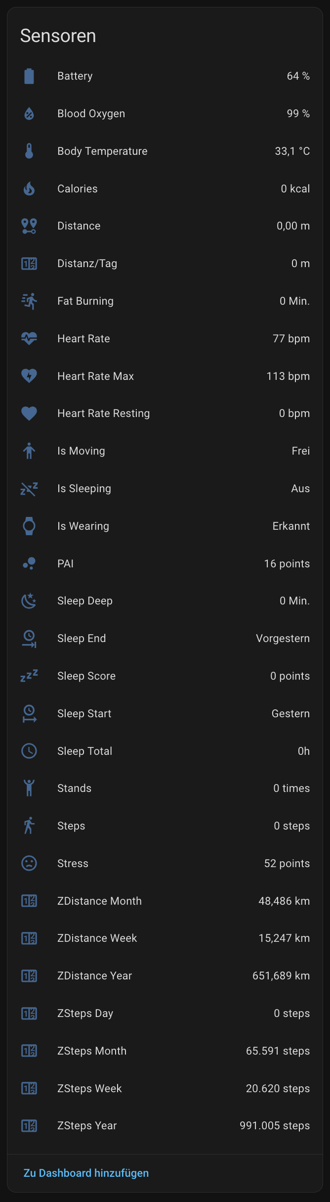

I’ve tried all those other health-to-ha apps that are available, your app price is very fair but I already sold my Apple Watch Ultra and got an Amazfit Balance Ultra that pushes all data to Home Assistant. So I pretty much stopped to look for a solution like yours. Also, I am missing a ton of data compared to Zepp2Hass (see screenshot, and thats just the health data, workout-list is also looooong). But I am sure you will continue to work on this, right?
Thanks again, Lutz
Oh, I am just days away to make the 1.000.000 step this year as you can see at the bottom of the screenshot :wink: by the way the zeros are related to the time (it’s short past midnight here).

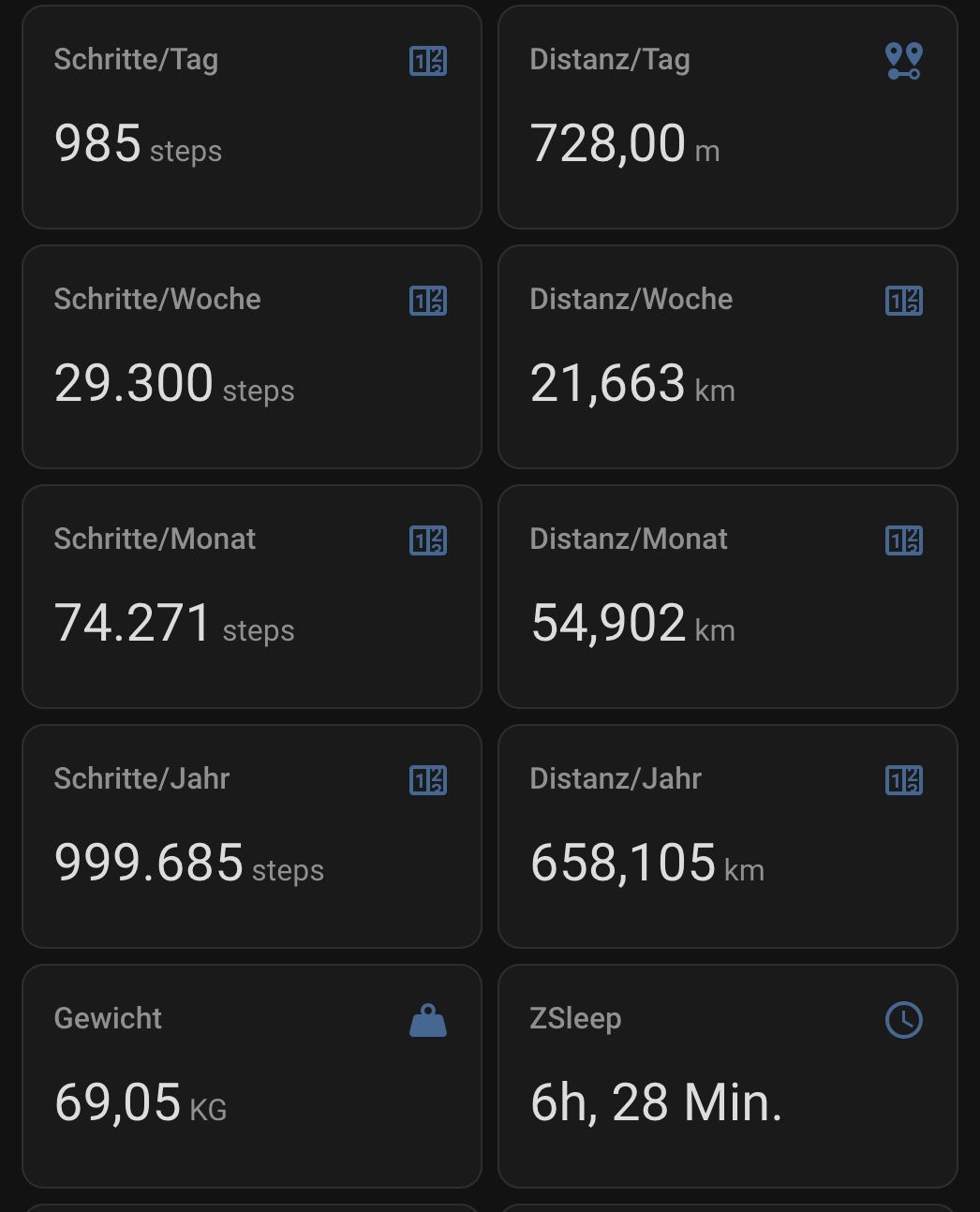

I’ve created that counter in my Home Assistant - daily/weekly/monthly and year. Will do the 1.000.000 Step this year by end of the day :slight_smile:

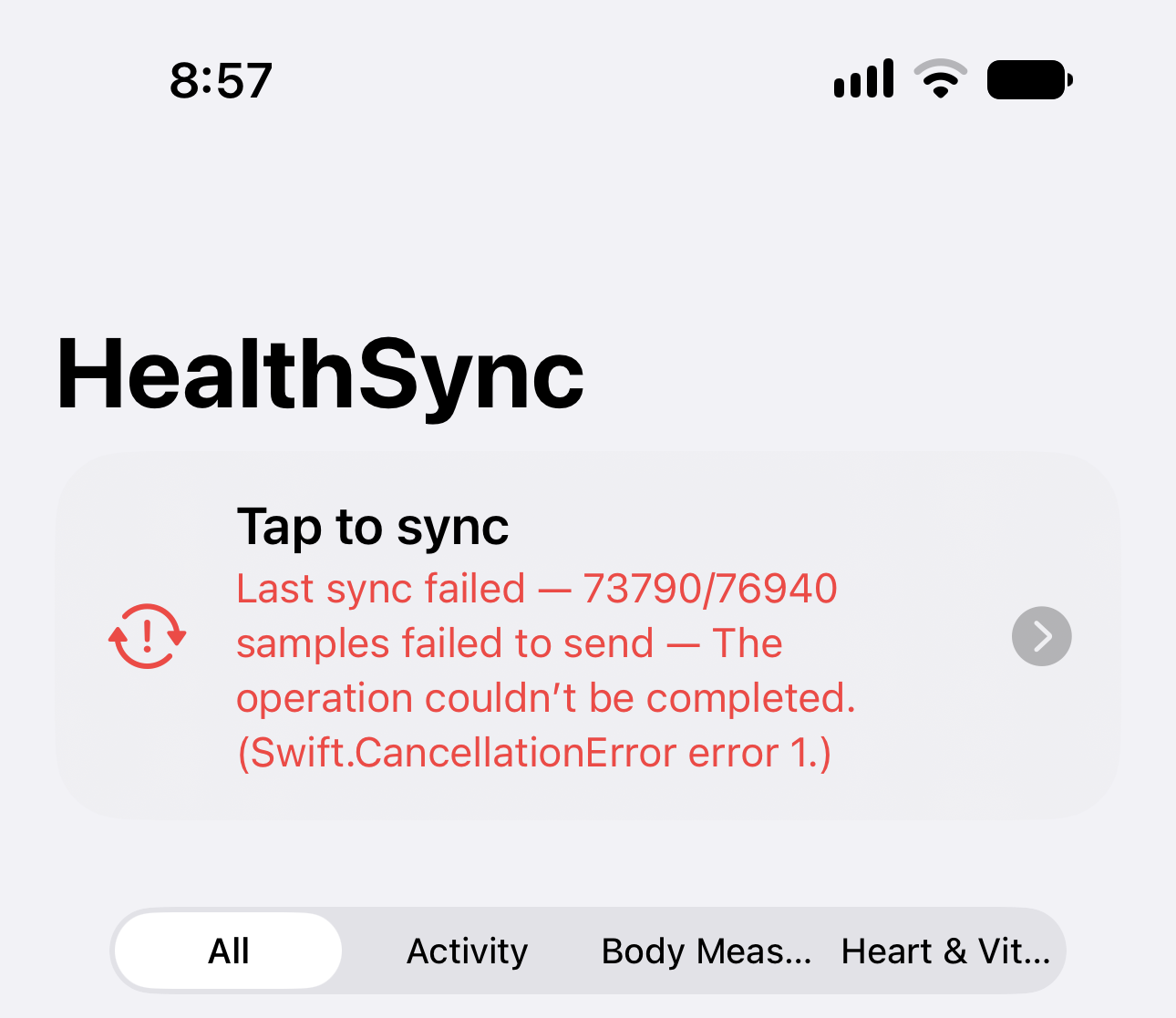

Hello. I am constantly seeing this error when the app is open. Though, in HA the sync entity shows it is syncing with it’s refreshing back to 1 sec. The testing of webhook shows good.
Could you also explain how the auto sync (paid version) works? Does the app needs to be set correctly for it to auto sync with HA? How often does it sync? Do we need to have the healthsync open for it to sync?? Thank you.
Hi. You might be seeing an error as you have a huge amount of Apple data to sync which is timing out. The update should do it in batches however the amount you have is incredible!! iOS has a limit that is set to around 20 seconds for background data loads which was timing out with some previous builds, recently this has been changed to allow a max of 1000 metrics, this is clearly not useful for your mammoth data log. I have made an amendment that seperates the manual sync and the background sync so the manual sync (when you firs install) works fine and loads all your history. When the next release is approved - iOS v1.4.2 this shoudl allow you to load correctly.
Auto sync doesn’t run on a fixed schedule — there’s no “every X minutes” setting, because that’s not something the app controls. Instead, iOS itself decides when to wake the app up and let it check for new data, based on things like how often you use your phone and battery level. In practice that usually means it happens every few minutes to a couple of hours, but it can occasionally go longer, like overnight, especially if your phone’s been idle.
This isn’t unique to this app — it’s how every app works when reading Health data in the background; no app is allowed to force more frequent updates. Manual sync (the button in the app) always works instantly regardless, since that’s not subject to any of this.
this should be fixed with the new app update, let me know if not :slight_smile:
v1.4.2 fixed it. Thx.

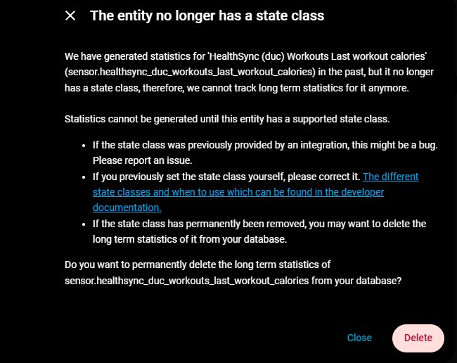

Hello. I received this message after updating integration to ver. 0.20.2. Ok to delete it??
Hello @duceduc - yes this is fine to Delete and ignore. It is just because the state has changed so it doesn’t exist any longer
