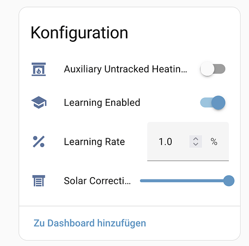

I don’t understand how I can add here more sensors. I have added the heat meter of my heat pump (1 for complete house) and the fireplace I trigger with switch.heating_analytics_auxiliary_untracked_heating_active.
My target indoor is 22.6°C. In winter time I only close the blind for each room if room temp is >23.3. If it’s getting then <23.1 they open again to get free heat.
I could change the Solar Correction in tha way that if 20% of the blinds are closed, I change the value to 80%. Is that correct?
The 2/3 of the windows are headed south (I added 160° in the integration). But the 1/3 are headed west. They also get affected by the sun in afternoon/evening.
How can I handle this?
I also cannot add the window area.
One last question: Where can I find the advanced sensors?
In your dashboard I think you use some custom sensors. A lot of entities connot be found in your dashboard.
Sorry a lot of questions :smiley:

1. Adding more sensors If you only have one energy meter for the entire house (the heat pump), that’s perfectly fine! You just add that single entity. You don’t need per-room sensors for the integration to work. The fireplace switch is also set up exactly right as an auxiliary source. The system will simply learn a single, highly accurate global model for your whole house based on that one meter.

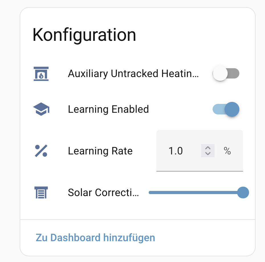

2. Solar Correction and blinds
I could change the Solar Correction in that way that if 20% of the blinds are closed, I change the value to 80%. Is that correct?
Yes, exactly right! That is a great way to automate it. Just note that if this slider was set too low (or to 0%) while the blinds were actually open during the initial learning phase, the system might have cancelled out much of the initial solar learning. It might be worth resetting the solar learning once your automation is in place, so it can learn the correct impact over a few sunny days.

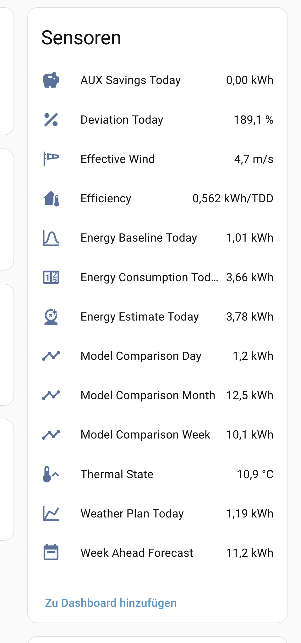

5. Advanced sensors & Missing Dashboard entities There are no hidden entities you need to enable. The reason you can’t find some of the “advanced” sensors or entities from the dashboard is that a lot of the rich data actually lives as attributes on the main sensors, rather than as separate entities. You’ll find things like forecast accuracy breakdowns, specific weather data, solar coefficients, and the hourly log there.
  • To view them in the dashboard: Click on the sensor, click the three dots in the top right corner of the pop-up, and select “Attributes”.
  • To view everything at once: Go to Developer Tools → States in HA, search for heating_analytics, and click on any sensor to expand its attribute list. (If you are building custom dashboard cards, like the Plotly graphs, you can also extract them directly in YAML using attribute: your_attribute_name).

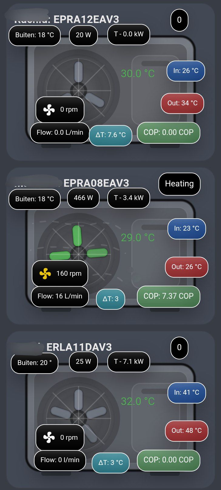

I might be able to help with that.

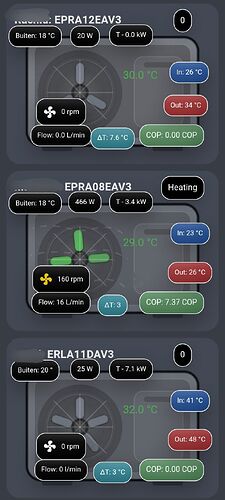

I manage three different Daikin heating systems, each with a unique setup, and I’m already monitoring them all through Home Assistant. Using the HACS Remote Access integration, I’ve centralized data from three separate Home Assistant installations into one main system, where I use Heating Analytics to monitor performance across all three.
Here is what I have running:
  1. New build (2023) – Full underfloor heating throughout the house, powered by a Daikin 8 kW EPRA08EAV3
  2. Renovated home – Underfloor heating on the ground floor, fan coils in the bedrooms, powered by a Daikin 11 kW ERLA11DAV3
  3. Renovated home – Fan coils in every room, powered by a Daikin 12 kW EPRA12EAV3
If it would help improve the ML models for hydronic systems, I’m happy to give you access to my central Home Assistant instance so you can pull logs and real-world data from all three setups. It might give you the variety of data you need to better tune the model for floor heating and mixed systems.
Let me know if that would be useful and we can arrange access,. send me a private message.

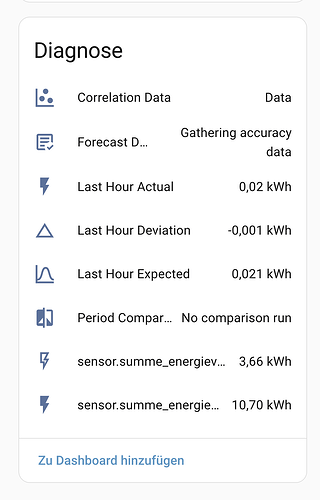

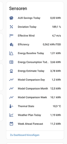

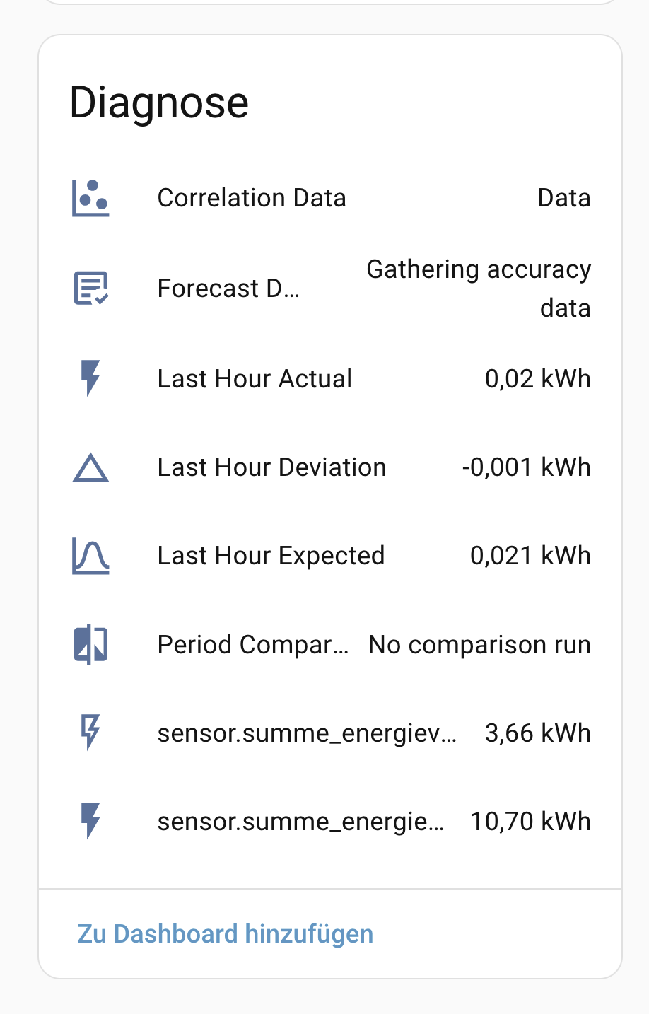

I installed it and had it running for some days. I’m not quite sure what to make of it.
Our house is nearly passive. We have a Vaillant Recovair, a Vaillant Arotherm heat pump, solar thermal, a 320 liter water tank, and solar power with a sg-ready coupling.
But happy to investigate new technologies to optimize our energy consumption.
Thanks for testing — your setup is a good one to stress-test the integration against: near-passive insulation, solar, and a 320L DHW tank all interact with the model in non-trivial ways.
A quick note on the UI: the top-level sensor state only shows a summary. The underlying thermodynamic calculations, correlation matrices, and data points are in the sensor attributes — accessible via the sensor’s detail view or Developer Tools → States.
Two things worth configuring before you let it run:
  1. DHW Mode — With a 320L tank on your Vaillant pump, you need to enable MODE_DHW (see v1.2.6 release notes). Without it, the energy used for water heating gets attributed to space heating, which inflates the learned thermal coefficients.
  2. Thermal Inertia — Passive houses have high thermal mass and slow heat loss dynamics. Set thermal inertia to 12 hours as a starting point.
Run it for 2–3 weeks with those settings in place. Once enough weather data has been collected, you can call the calibrate_inertia service in Home Assistant — the engine will analyse your historical data and recommend the correct inertia value for your specific house.
