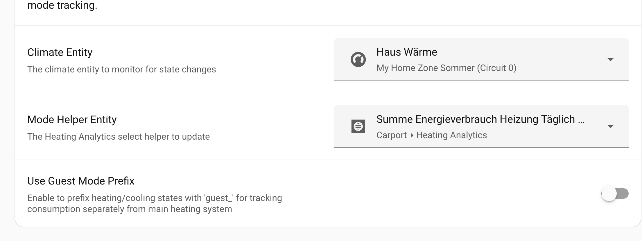

Like this? Or the other blueprint?

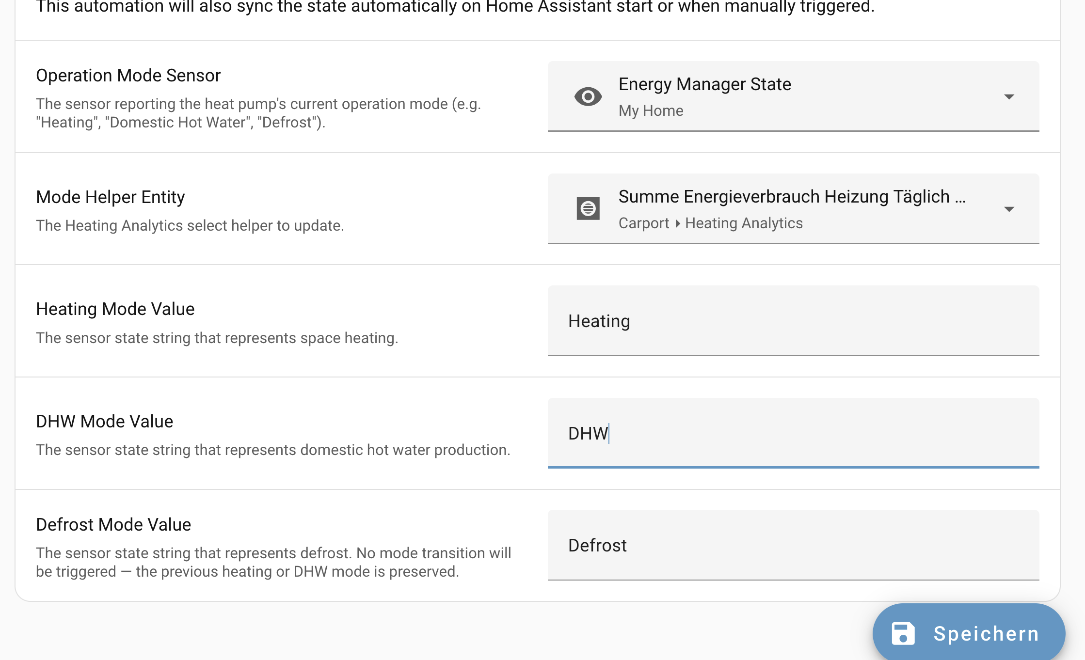

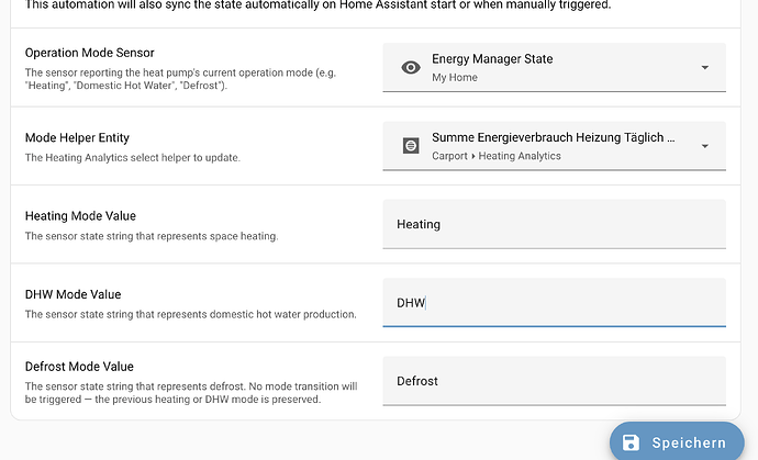

My heatpump also has STANDBY and COOLING, but no defrost.
This is correct. For now the blueprint ignores the defrost mode anyways, as it belonges to the previous state :+1:

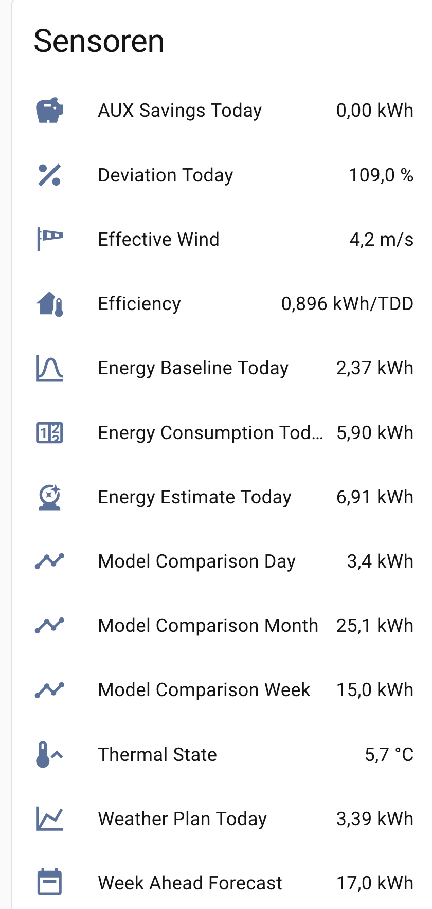

I wonder that these numbers all mean? Some of them I can guess. Are they documented somewhere?

On the diagnostic numbers
The full parameter reference is in the README (Configuration Options and Advanced Sensors sections) and the DESIGN.md covers the underlying model architecture in detail. If there are specific attributes or sensor values you’re seeing that aren’t clear, paste them here and I’ll explain them directly.

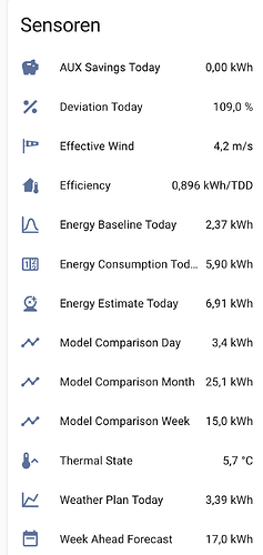

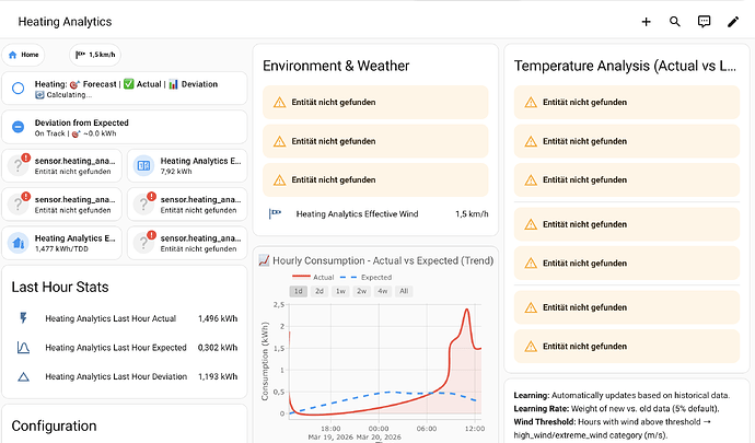

The dashboard I had to modify quite a not, most sensors were missing.
Not sure it it has any practical value, but interesting anyway :slight_smile: Learning about the third biggest energy consumer in the house is always worth it.

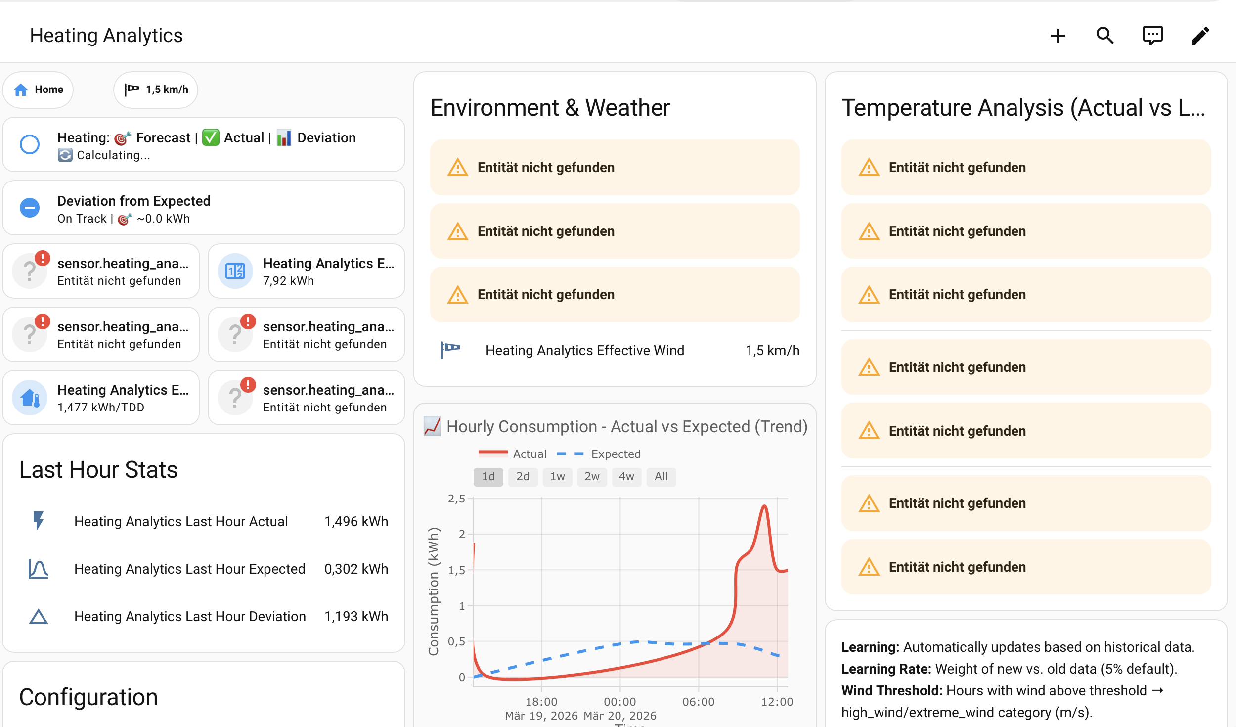

But i’m seeing a lot of errors on the dashboard. Have the entity names changed?
Hi @MartyBrMartin — thanks for the kind words!
Yes, this is a known pain point, and it’s actually pushing me to rethink the dashboard approach entirely. Rather than maintaining a single ready-made dashboard that breaks whenever sensor names or attributes evolve, I’m moving toward providing building blocks in the tools/ folder that you assemble yourself. More on that in a second.
For your immediate issue: the easiest way to find the correct entity names is to go to Settings → Devices & Services → Heating Analytics and browse the entities listed there — they’ll show the exact IDs as they exist in your installation.

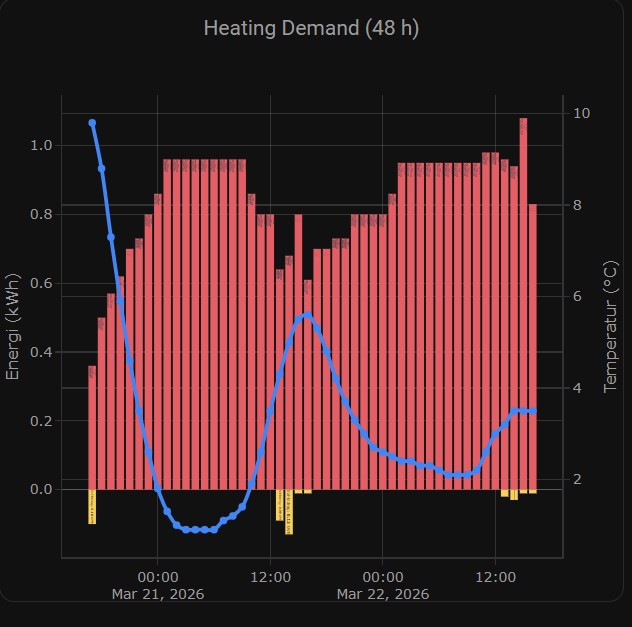

The tools/ folder now contains a growing set of ready-to-paste Plotly graph cards. Here’s a taste of what’s in there already:

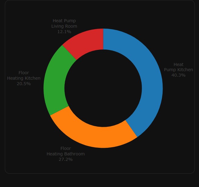

  • plotly_today_breakdown_pie.yaml — donut chart of today’s per-unit energy split

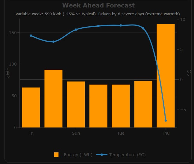

  • plotly_week_ahead_forecast.yaml — 7-day bar + temperature line forecast
  • plotly_heat_demand_curve.yaml — heat demand vs. outdoor temperature, segmented by wind
  • heating_forecast_sensor_and_dashboard.yaml — 48-hour hourly forecast with solar contribution
These cards plug directly into standard integration sensors — no fragile pre-built dashboard to maintain.

Thank you so much for the quick reply. I only installed the integration a few days ago and am currently exploring its features.
If I notice anything or have any suggestions, I’ll get in touch right away.

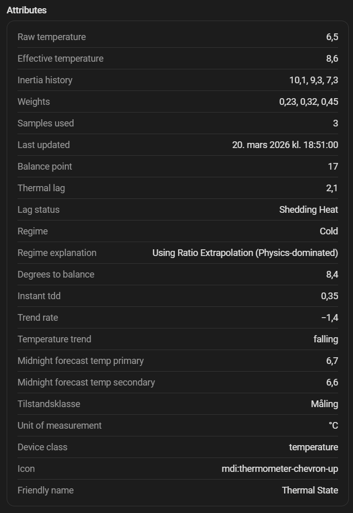

Hi, some entities are missing on my system.
For example, “sensor.heating_analytics_temp_actual_today”
There is no entity with “temp” in its name under Heating_Analytics.
Hi again @MartyBrMartin — yes, that confirms it. sensor.heating_analytics_temp_actual_today is a relic from an early, pre-public release of the integration and no longer exists as a standalone entity.
The integration evolved quite a bit during its alpha/beta phase before the official release. As the data model matured, several sensors were merged, renamed, or moved into attributes to keep the entity registry clean. The old pre-built dashboard unfortunately just didn’t keep up with those early architectural changes.
Because of this, I’m moving away from maintaining a single monolithic dashboard. In fact, I will be removing that old dashboard template completely as soon as I finish extracting the remaining useful graphs into individual, modular cards.
For temperature-related data, you’ll now find it exposed as attributes on the Thermal State sensor, which provides rich information that a single entity never would be able to. The standalone Plotly cards in the tools/ folder show exactly how to pull those out directly for your own dashboards.
