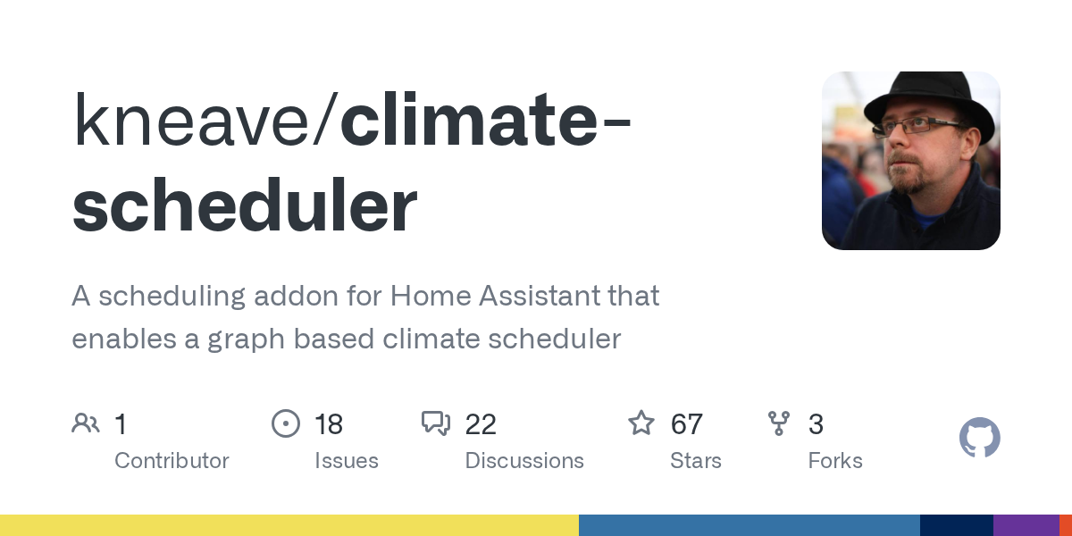

For aggregate sensors my addon generates those for every entity that’s added to a schedule. It adds sensors for the coldest and warmest rooms and I can add similar sensors for highest and lowest temperatures requested by schedule easy enough. Should be able to get it to return the highest value where heat has been requested so it’d be the valid temperature to work from. If none requested return null?
Have a look, if it sounds a useful feature I’ll get it added.

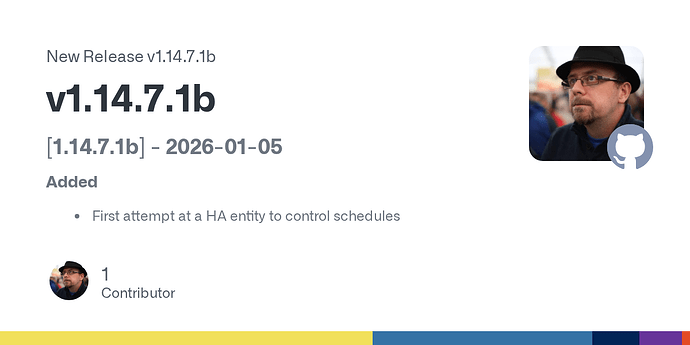

Someone else nerdsniped me with an idea but it should help you too. I’ve just added a feature to expose the schedule as a climate entity, this will show the average temperature for the grouped thermostats but there are more attributes in there too.
You can override the group temperature and control the group as if it’s a single entity. You can also select the preset for the specific schedule if you’ve created a few already so should be easy to automate for presence by creating home and away profiles and switching with a trigger.
This is something I hacked together over the past few hours, it definitely needs testing so any feedback is welcome.
