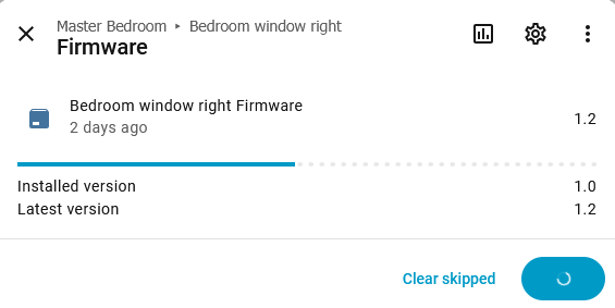

I got a couple of the D1-M Matter-over-thread door sensors and after a few issues they generally work. Perhaps a firmware update would help, but the update keeps failing.
I am on version 1.0 and HA offered an update to 1.1. I started the update but after showing a progress bar for multiple minutes it failed. The only effect was that the sensor state was toggled from closed to open. I opened and closed the window and the state was correct again.
I tried this repeatedly on two of these sensors and again after the 1.2 version was offered. The same failure with the same side effect on the sensor state happens every time. There have been several HA reboots, restarts, and updates along the way and none of that seems to matter.
Has anyone else used these particular sensors with Home Assistant? Updated firmware successfully? Might this be something that works better on other platforms, or is this sensor just not very good?

Thanks. I put the sensor on my desk and simulated a close/open cycle with a magnet. I then started the update with 1 second. The progress bars is moving, about 35% at 100 seconds.
At 280 s it went to a fast sliding animation instead of the slow progress bar. It stopped at 320 s, still showing 1.0 installed and 1.2 latest.
I tried the Identify function and the sensor flashed, showing that it is awake. I ran the update again. Identify and open/close operations show up in the Activity log, but there is nothing about firmware. This next attempt gave the same result, except that the fast animation ran until about 10 minutes had passed.
Try to regular keep it alive with the magnet while it updates.
And other than that it is probably just keep trying.
Okay, I stood there and waved a magnet at it about every 5 seconds. This generated a closed/opened flash each time, except maybe once. I also learned that when the animation changes from the progress bar to the animation, a green light flashes once.
Still stuck on firmware 1.0.
