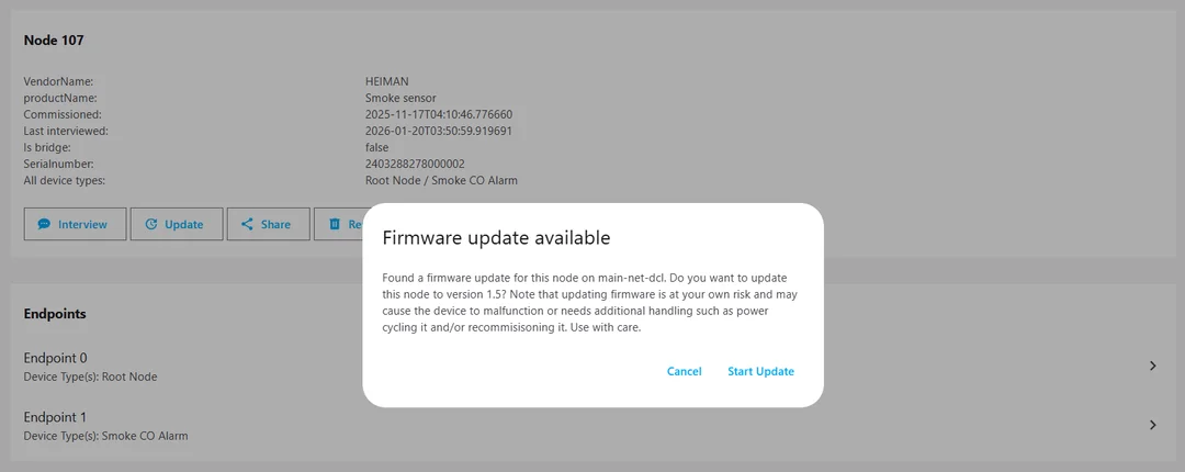

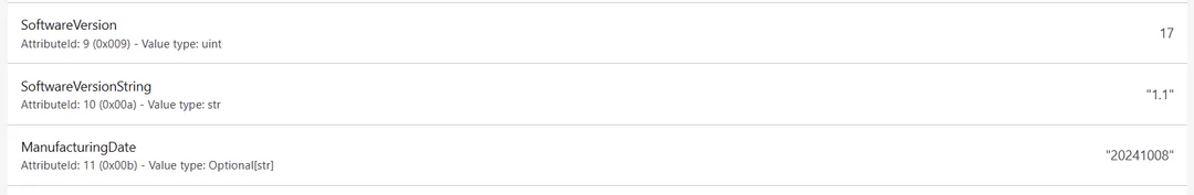

How to identify the version?

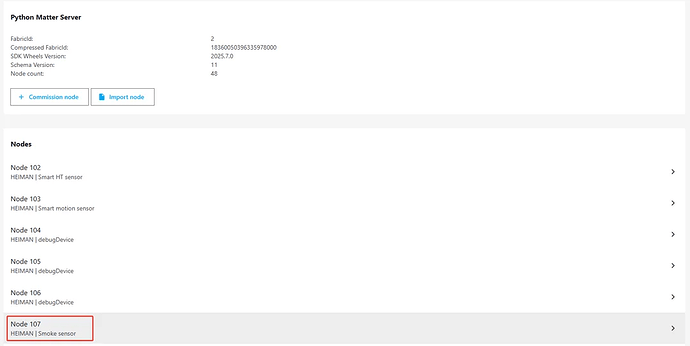

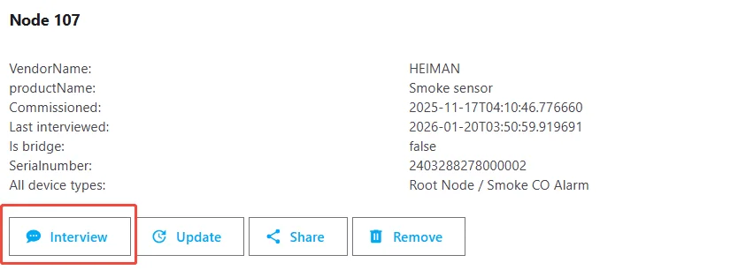

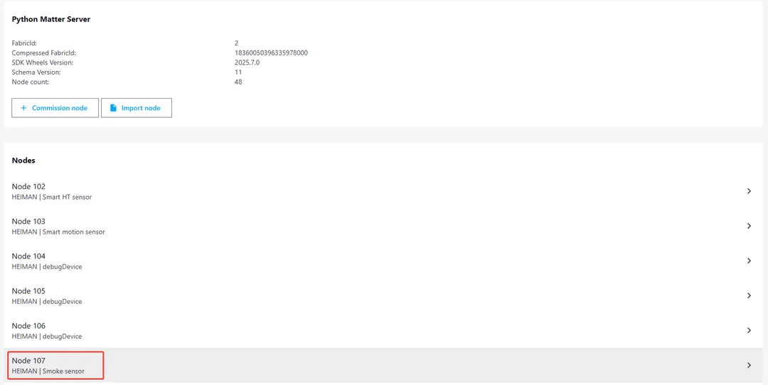

  1. Open the Matter Server UI and select your smoke alarm to go to the device page. Click 'interview' and wait for the process to complete.
  2. please check the SoftwareVersion and ManufacturingDate in basicalinfomation cluster as below:
  3. if the date is older than May 2025 (because Matter 1.4 was released at early of 2025), please update an interim firmware, let's say 1.1, and then update to 1.5 version, if your sensor is newer than that, you can skip this step and update directly.

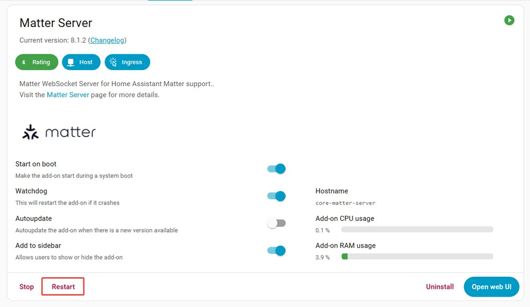

  1. restart your Matter server:

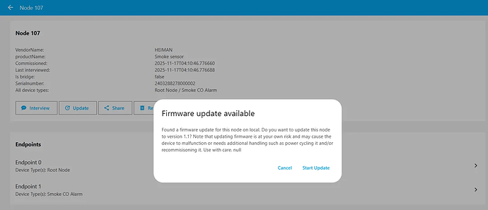

  2. navigate to your smoke alarm page again, when you click the update, it will indicates you version 1.1
  3. Waiting for the update to complete, and wait a while, reinteview your device again, it will shows 1.1 version:

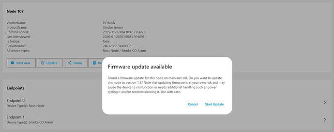

  4. remove the json file and restart Matter Server, and now, you should able to update to version 1.5
  5. when you finished the ota process to 1.5, you may need to re-pair the smoke alarm, after re-onboard, you should see the version has shown version 1.5.

ha addons restart core_matter_server

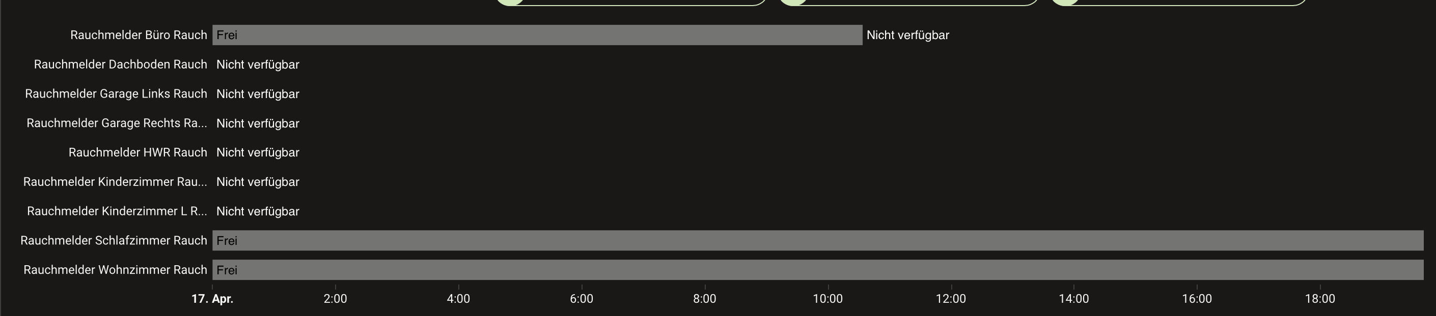

Does anyone have issues with this entity lossing the connection?
I have many issues with the fire alarm becomming unavailable for different periods sometime as long as 8-12 hours, sometimes 1 hour or less.
It was a bit more stable on version 1.5 but I upgraded to version 1.6 and now it does not stay “connected” for longer than 24 hours :confused:
My ikea door sensor sitting next to it has much less issues being connected.
Both matter ofcourse.

Came here to check in, too, as I just experienced the same. Two alarms showed up unavailable very close to each other, from a timing perspective, the rest of the network is stable, just these two went unavailable 4hrs. back. One of them came back online, the second not yet. Both on v4.2, Matter server updated to the 10th Apr release. No network changes nor router disconnection, and there’s three OTBR in the network from Home Assistant (ZBT-2), Aquara (M3) and Tado (Receiver X). It doesn’t seem a coincidence that we’re a few users seeing the same thing. A third smoke sensor did not experience this, and another 4xCO sensors from Heiman also kept online.
Have the same problem 2 of 11 smoke detectors are online after 1.6 update. 9 others needs a reset
I also notice a battery drain on 2 of 9 unavailable smoke detectors as they are beeping
