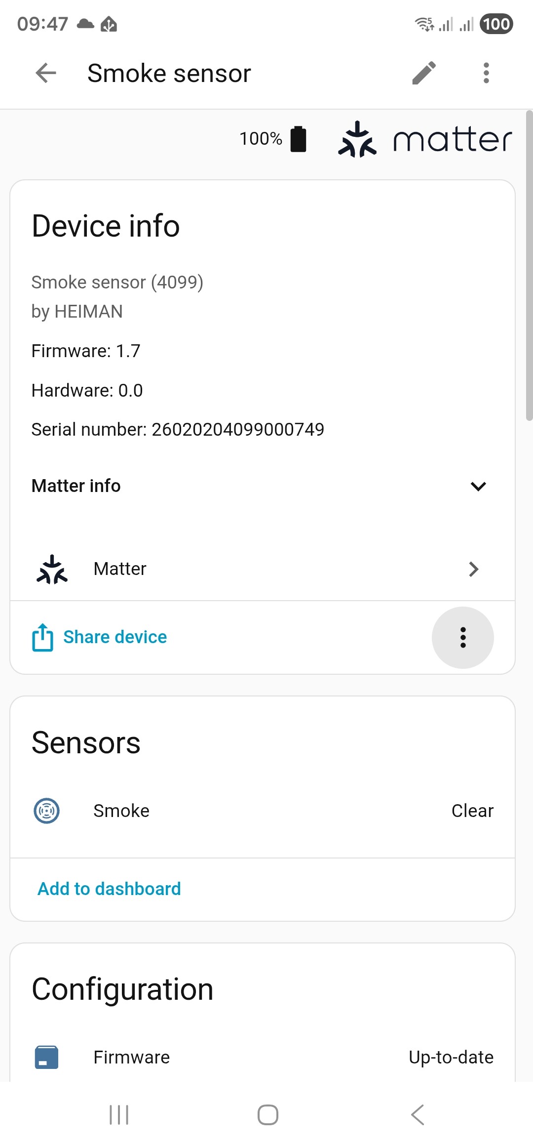

I've updated my one. It's worth saying that it took a while to upload the firmware - which is the low bandwidth of Thread - but the "Installing..." phase, which has no progress indication, took about 5 minutes. After that it seems to be working fine but even after a "Re-interview Device" through Matter, it isn't offering a siren feature. I have self test and identify still, but no siren. Both these work but there can be a five second or so delay presumably as the device is sleeping a lot of the time.
It's also worth stating that my device has not dropped off the network in the last 24 days.
I'll report any connectivity problems with the new firmware if they happen.

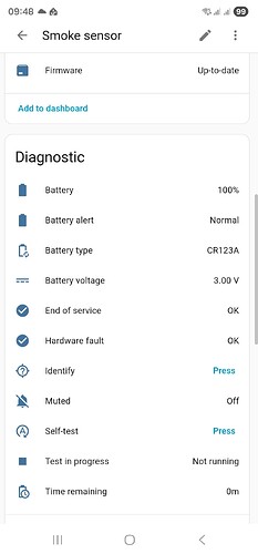

Hi leoXie. I don't have the option to mute but I do have a status of whether it is muted or not.
I understand about the siren feature now. It needs changes to the Matter server as well as the firmware. I think I'll wait until those get merged; I'm not in a hurry.
Out of interest, is a self-test quieter than a full alarm?
Hi Gareth,
if you update it to v4.3 and HAOS 2026.5, you should able to see the mute right away, but of course you can use v1.7 if you don't use remote mute for the moment.
Regarding the level of sound, yes, nice catch, that won't scare users at first pattern, but if you keep pressing it, the sound will get louder and louder till reaches its maximum.
I'm already running 2026.5 but as you say, it isn't a function I'm using yet. It will be a nice-to-have feature though.
It might be worth stating on the instructions that a self-test is not as loud as a full alarm. It's nice to be quieter for a test so you don't deafen yourself but unless you know the proper alarm will be louder, you might think it isn't loud enough to wake people through closed doors.
only the first pattern of test sound is reducing a little bit, and it isn't reduces pretty much, it doesn't counts as a feature.
