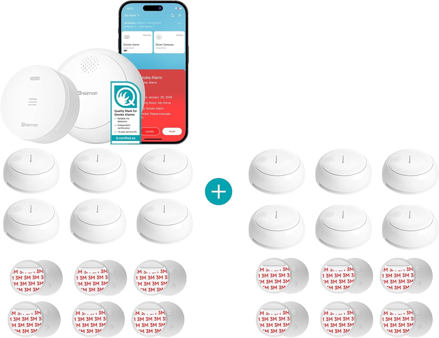

Hey CJB,
Are you looking for this suite?
We are developing the Heiman Home integration and it should able to use with HomeAssitant.
I am not bored but we do browse the forum from time to time, if I missed it, you can DM me anytime, would you mind that I DM you for more details?

Many thanks, @leoXie - the gateway portion of the kit you linked does look very good! From what I could tell from the product link (the product images were in German) it does seem to match what we need. Is that gateway compatible with the HM2SA-1 model that’s sold in New Zealand?
Amazon Germany won’t send those bundles to NZ, plus we only need the gateway itself since we have installed the alarms already, so might you know if the distributors here will be able to sell the gateways individually soon, like Cavius does now?
And of course, you’re welcome to DM any time, I’d be very happy to help with whatever info you or your team need. :blush:
