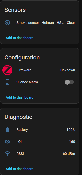

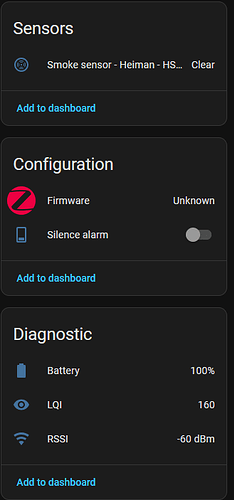

I used a tuya quirk and managed to add it to ZHA, but it’s not exposing all possible entities, for example tamper detection. Firmware shows unknown status only and I’m not certain that the battery percentage entity is showing the actual battery level, or something else etc.

Thanks CJB. It was wishful thinking! I had to instal interconnected alarms end of last year after a reno according to the new regs. Picked the Heiman as seemed best value for money. 8 or 9 and 2 heat sensors, They work well. Would like to have them integrated into HA. I didn’t want the interconnected bit of smoke alarms dependent on HA

I can confirm they work with HA and I added them using the direct method shown in this guide
The smoke alarm exposes battery level, detection state and controls to test it.

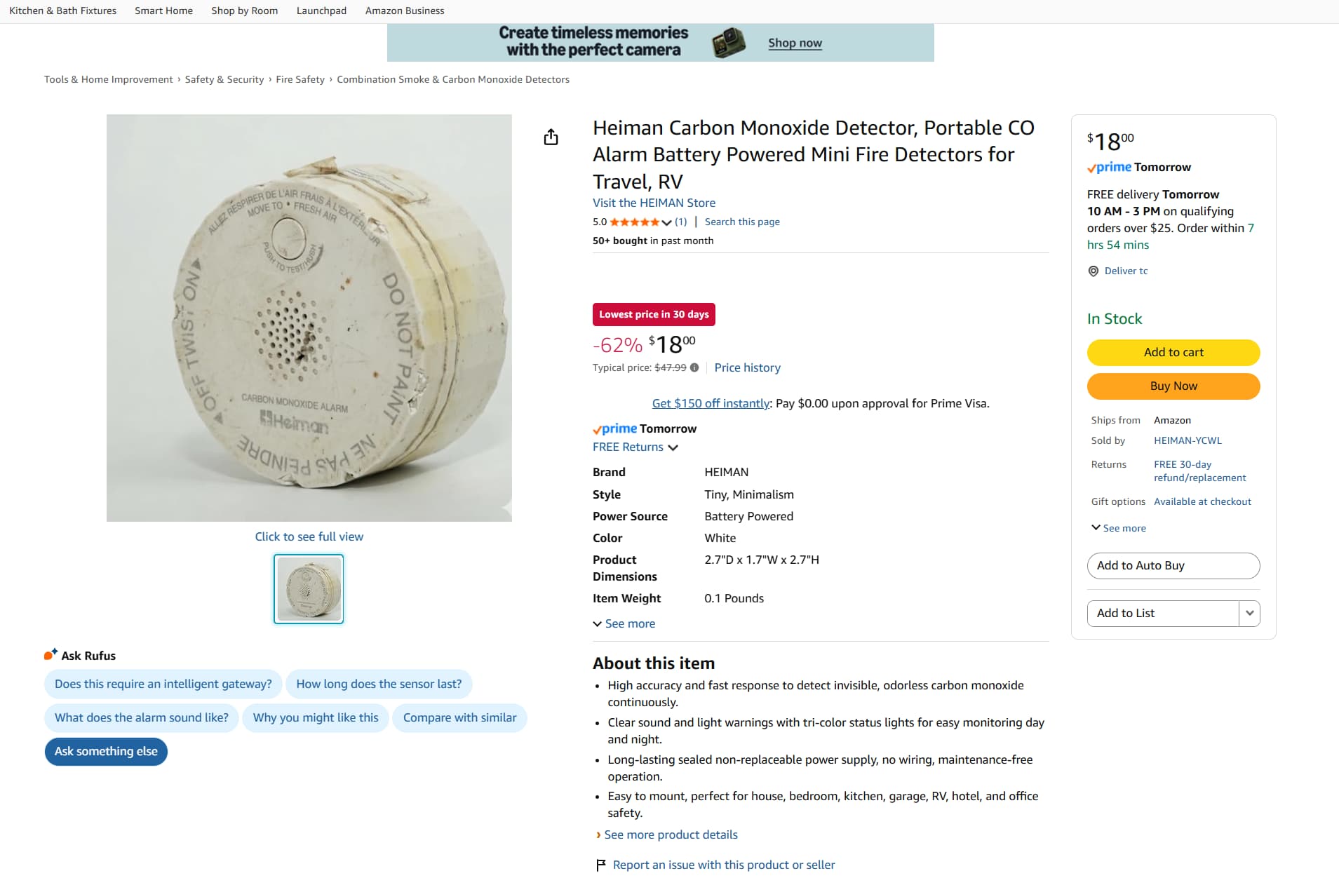

I thought this was an April Fools joke but it’s actually a real product posting on amazon… how can they possibly list something like this?
Grabbed a screenshot - notice the picture… it seems like it fell off a truck…:
Downloaded amazon picture:
Lol, just curious on how this happened ![]()
Edit: removed observation I must have hallucinated on to avoid causing confusion - rest above still applies.
…or fell under the truck! Not sure if your couriers are anything like some of the couriers here in the UK but maybe the picture is so that they can tell you what was delivered almost exactly matches the picture!
