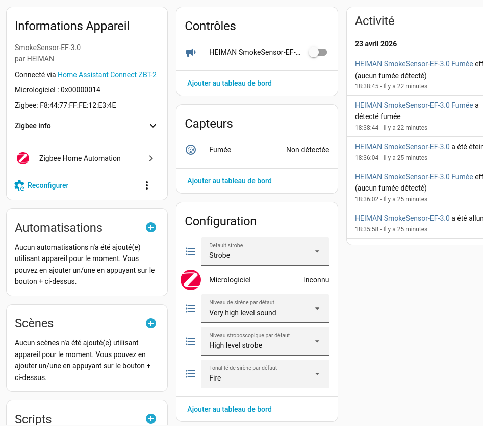

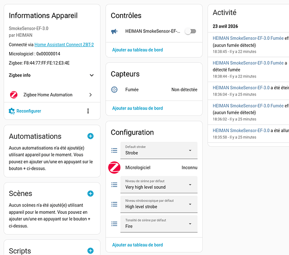

Hi. I bought an HS1SA-EF, but there are no updates available and the siren doesn’t work. How do I update it using ZHA? Is there a custom file?
I am pretty sure there is a custom FW file. Also awaiting for the reply related to this topic :slight_smile:

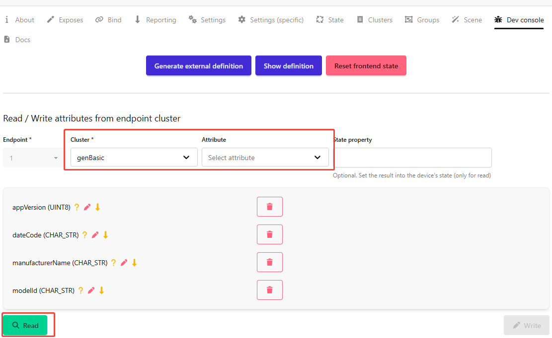

could you send me these info by reading it.

Could you read the datecode of it for me? thanks.

here it is
25.04.2026, 17:52:18] zhc:tz: Read result of ‘genBasic’: {“appVersion”:19,“dateCode”:“20241221”,“manufacturerName”:“HEIMAN”,“modelId”:“SmokeSensor-EF-3.0”}

The datecode for me, using ZHA is 20251023. I thought this product was plug n play but it’s not
