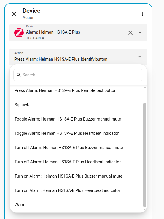

So I’ve tried using the HS1SA-E Plus as a Zigbee siren for home security. There does not appear to be a way to do this cleanly using an automation in ZHA as the only options to turn the siren on via a trigger appear to be via remote test button or warn, both of which give just 3 or 4 siren bleeps. I’ve done a bit of a workaround to achieve multiple siren bleeps but its messy. It would be nice to be able to simply switch the siren on (and off) via a trigger in ZHA.
Volume control on the HS1SA-E Plus, via ZHA, would also be useful. If its already there, apologies, but I can’t see it.

could you try to give it a duration? this is a workaround for ZHA, it may fixed in the feature.
action: siren.turn_on
  duration: "200"
  entity_id: siren.heiman_hs1sa_ef_3_0

Couldn’t get duration to work, but I’ve achieved similar effect by having an Action repeat Press Alarm multiple time.
if you would like to solve this issue, you can replace my quirks file, and it will exposes two types of sound in HA.
In order to be consistent with HA, so the merged quirk was using standard zigbee siren operation.
