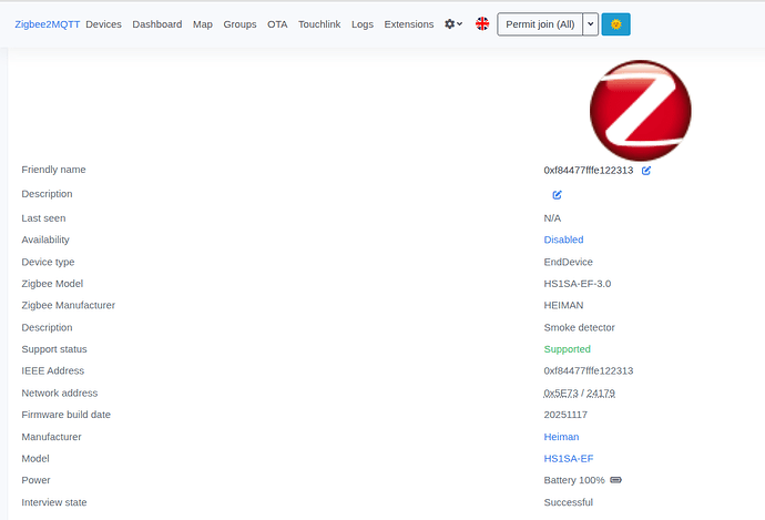

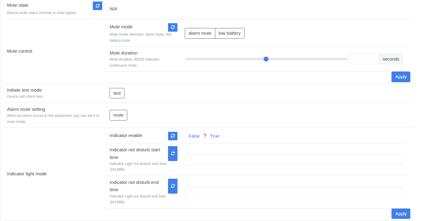

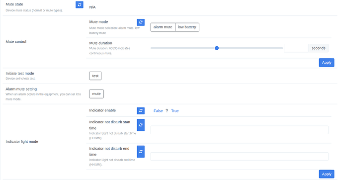

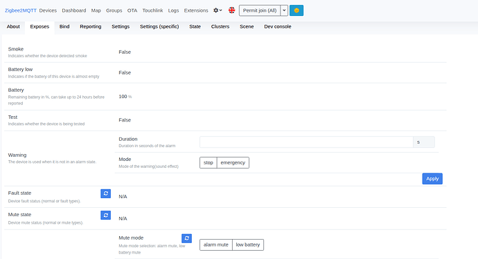

This is Leo from Shenzhen Heiman Technology Co., Ltd. we started a new team to focus on the experiences for DIY users, we’ve got a lot of feedback of adding more functions to our smoke alarm, like the mute alarm, remote test and interconnection, etc, and now, here we are …
we are going to start with our zigbee smoke alarm which model named HS1SA, if you guys love it, we will do these updates to more models of our smoke and CO sensors. including our matter smoke and co alarms, but now, we can only do that with Home assistant.
So here is the engineering sample that we have added to Zigbee2mqtt, if we can get your suggestion and proposal, that would be a great honor to us, we would appreciate your advice, we are all ears.
Thank you all in advance.

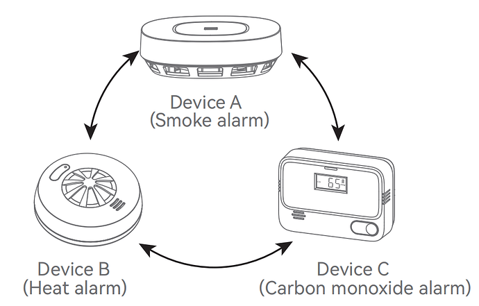

Hi @WallyR , Thanks for the proposal.
Regarding the linked function, do you prefer wired or wireless interconnection? if you prefer wireless interconnect in matter standard, it has to require a thread dongle that running thread on Home assistant, currently, the smoke alarm running on matter protocol, it can not communicate with each other without parent.
we have Sub-G solution that is able to do that, but it can work standalone with matter, it requires a matter bridge.
here is a simple topology for your reference, the smoke alarm can be connected with CO alarm and Heat alarm wirelessly, if you also have a gateway, the information can send to you app, if you don’t have, those devices still are able to link each other locally.
