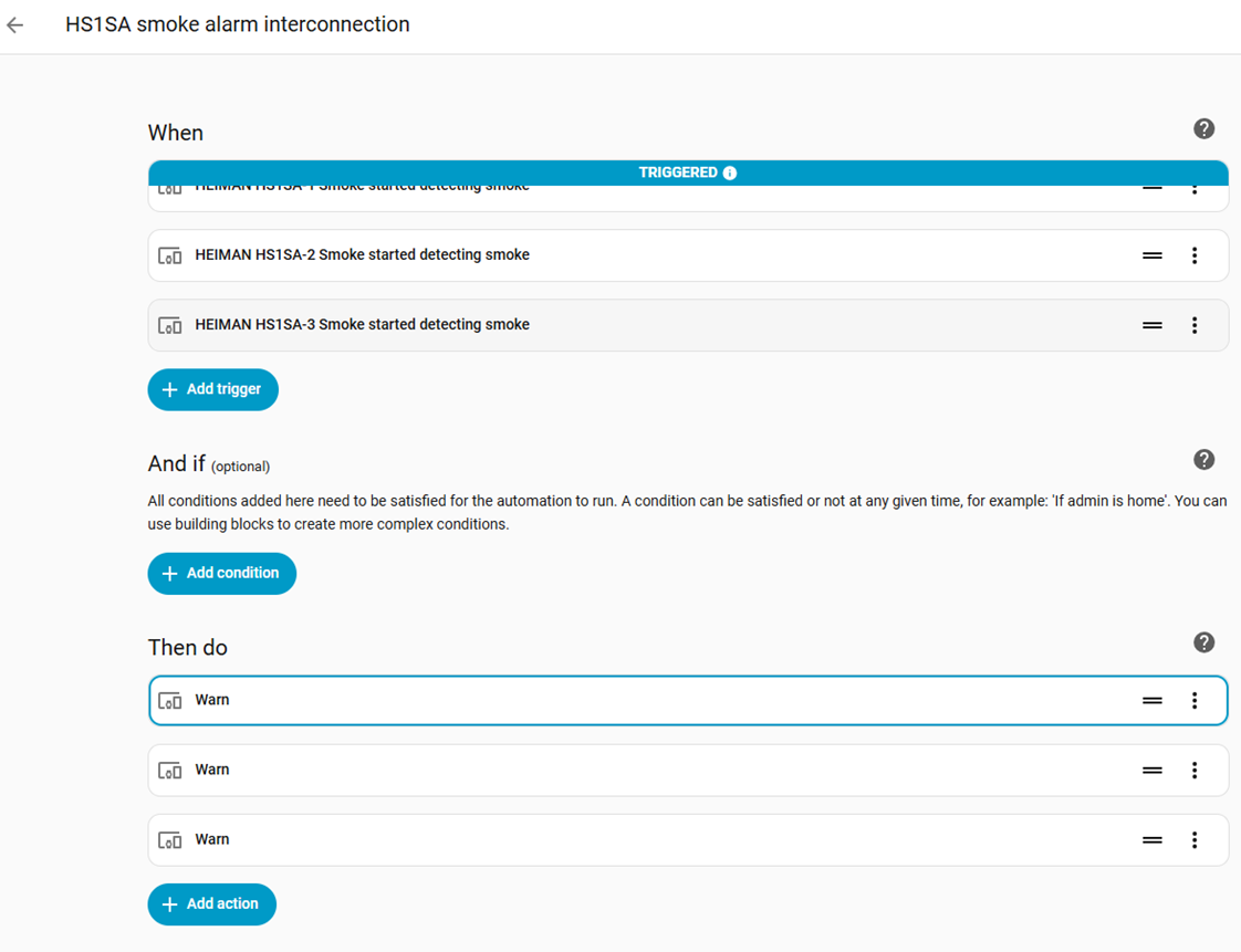

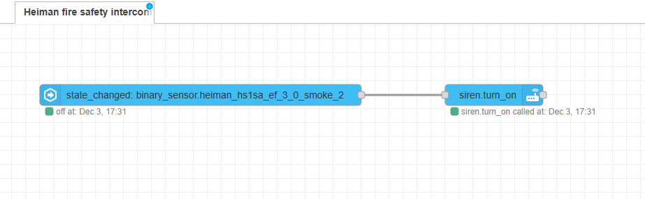

update: we tested the siren in ZHA, we may still need to develop the quirk to support mute and test function.

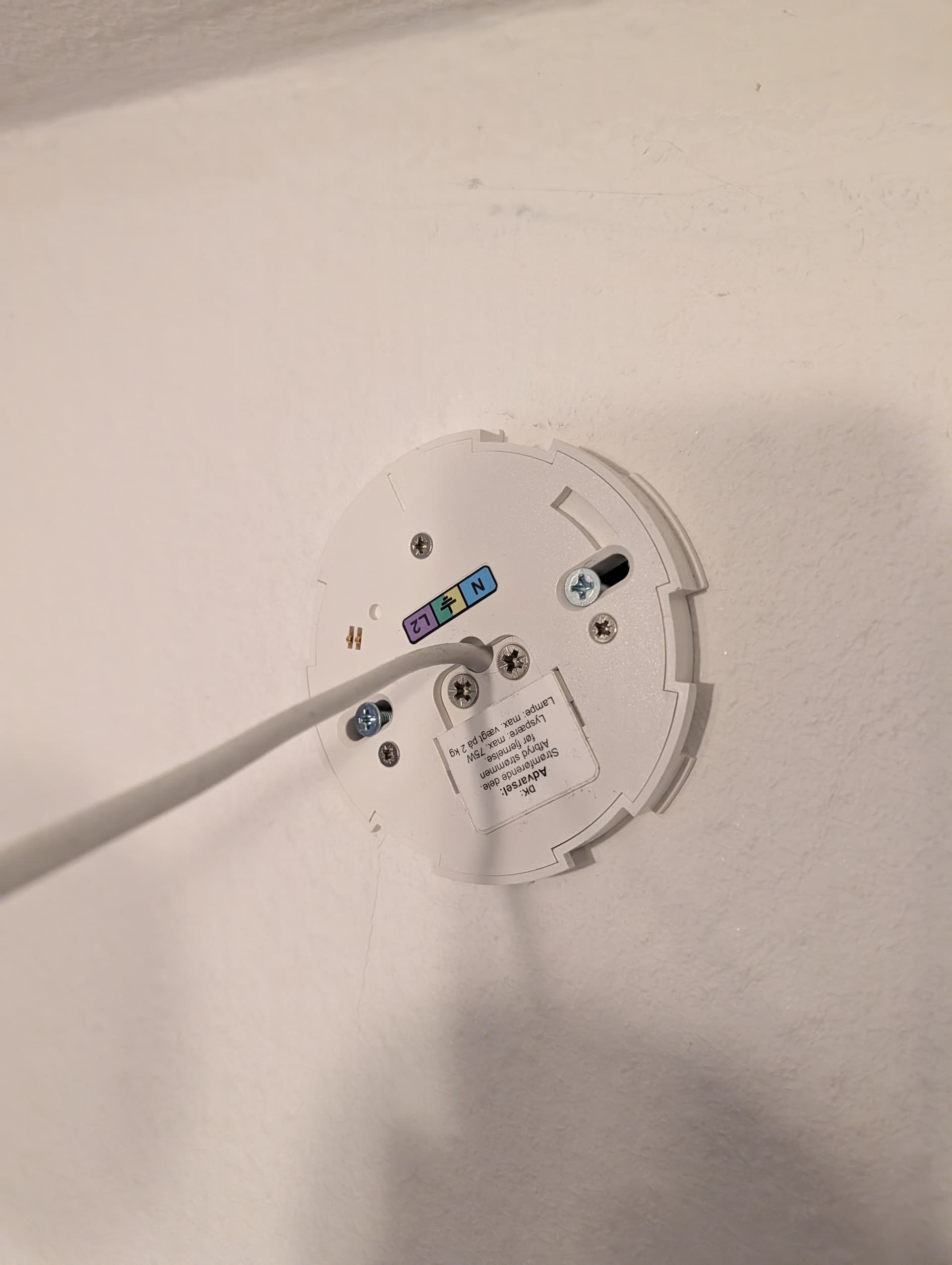

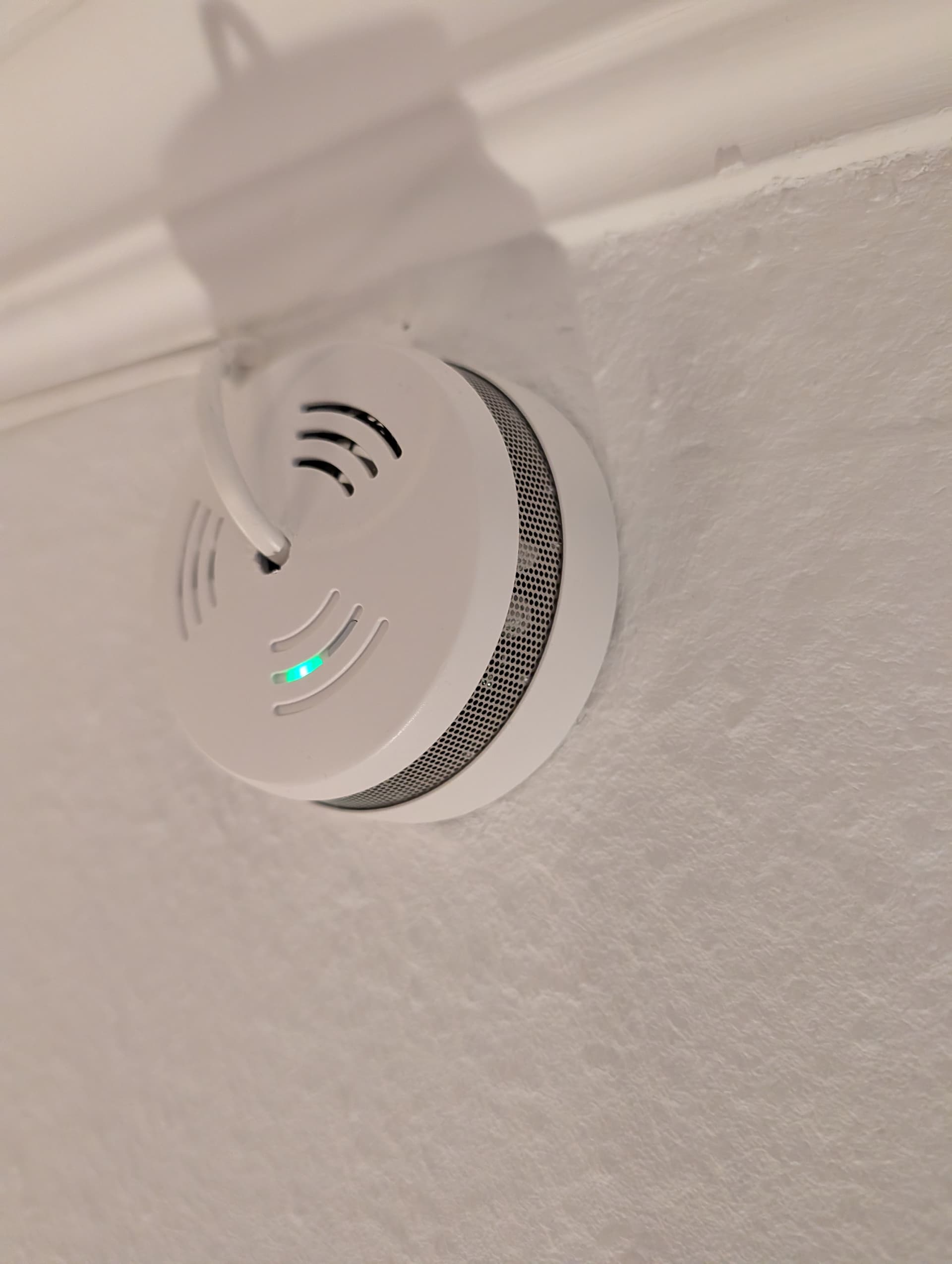

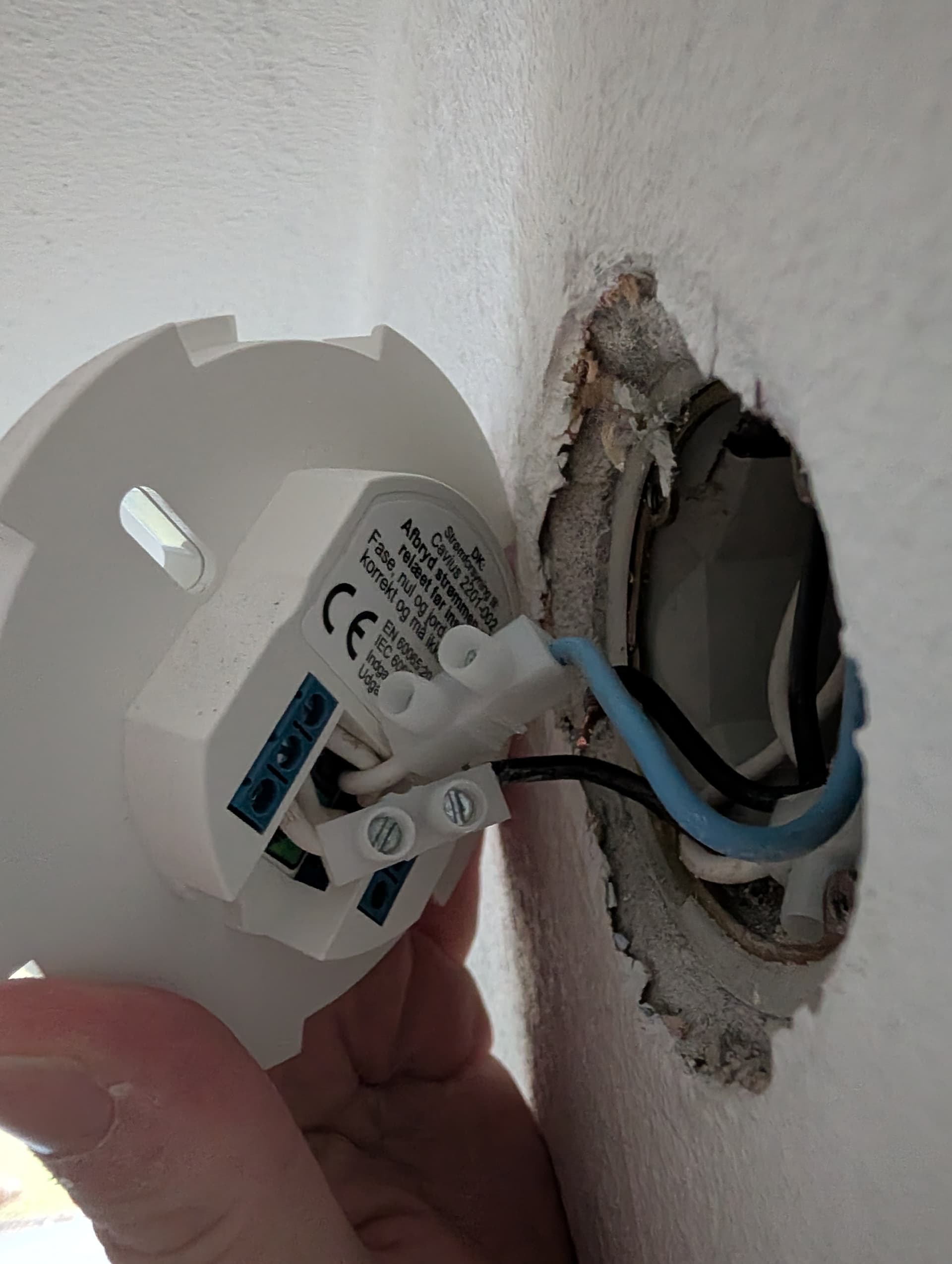

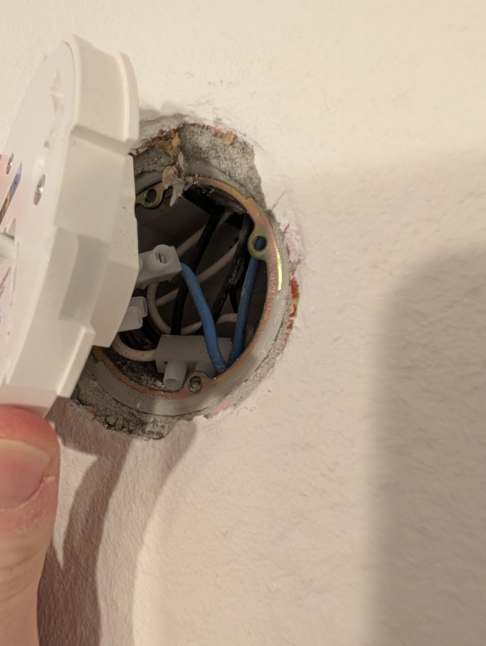

It was not easy, since I had fixated the cables, but here they are.
The smoke alarm is twisted on the base and the base contains the conversion of power and provide it through the two small metal clips.
Below you can see the metal ring that I have iny lamp outlets. The little hole in the right by is a screw holes to fixate stuff.
Many European countries have similar devices to fixate stuff on the lamp outlet and if not then you would have to drill.
The base have grooves for screws that can slide, so different diameters of the fixation fixture can be accommodated.
