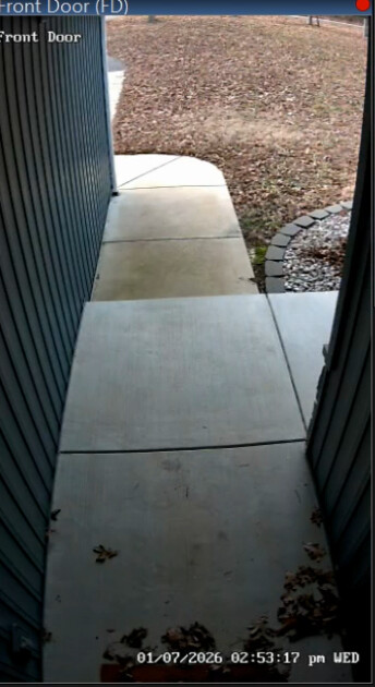

My cameras are all POE Reolink. I have another server running Blue Iris Software for the NVR and linked into HA. For my doorbell, I have a door-in-a-tunnel kind of thing. So doorbell cams were horrible. Reolink has a cam that can be turned 90 degrees and has a ‘corridor’ mode. I use the motion of the camera for DB notification.
