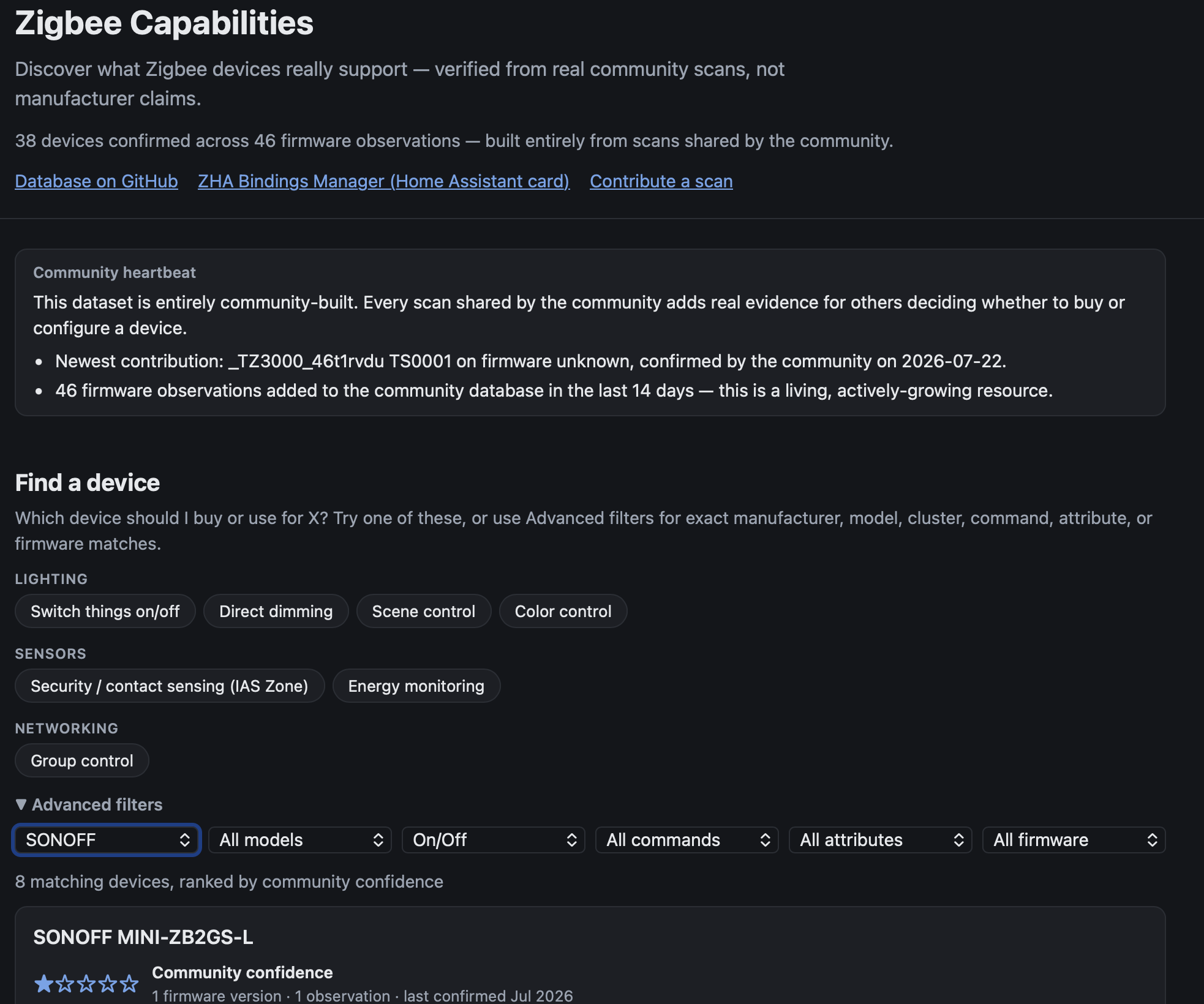

Browse the standalone Capability Explorer
The public database can be explored here without installing anything:
Zigbee Capabilities — community device capability database
It currently allows you to:
  • find devices by practical uses such as on/off control, dimming and scene control;
  • search by manufacturer, model, cluster, command, attribute or firmware;
  • inspect the capabilities confirmed for a device;
  • see the strength and recency of the supporting community evidence;
  • compare two observed firmware versions and see what changed.
The interface tries to explain capabilities in user-friendly terms while keeping the underlying Zigbee commands and evidence available for anyone who wants the technical detail.

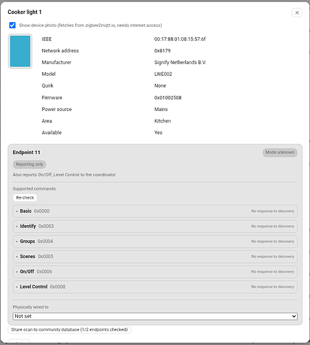

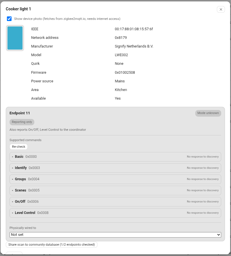

Using the card (v0.29.0) my devices seem to be timing out when I try an “exploded” scan. This applies to mains and battery devices, and I’m doing a normal bindings scan first, so they are available. I just get “No response to discovery”.
Edit I get these errors:
This error originated from a custom integration.
Logger: custom_components.zha_toolkit.scan_device
Source: custom_components/zha_toolkit/scan_device.py:404
Integration: ZHA 🧰 Toolkit (documentation, issues)
First occurred: 11:49:36 (11 occurrences)
Last logged: 11:51:21
got Status.UNSUP_GENERAL_COMMAND status for discover_commands starting 0

That’s very helpful data - thank you.
Quick summary of what’s going on with your Hue bulb, and what the card does about it:
Your bulb answers basic “what are you, what do you have” questions from Home Assistant just fine - that’s how the card already knew it has clusters like On/Off and Level Control, and why the normal bindings scan worked.
“Check supported commands” queries each of those clusters “which exact commands do you support?” That’s an optional extra question in the Zigbee standard - a device can fully support On/Off without also supporting the separate “please list what you support” question. Your bulb doesn’t implement that optional question, and rather than staying silent, its firmware correctly replies with a standard “not implemented” response.
On the Bindings Manager side, the card’s “Check supported commands” button runs through zha-toolkit (the integration doing the actual scanning), which in turn uses zigpy (the underlying Zigbee library Home Assistant’s ZHA is built on) to send the request and decode whatever comes back over the air. In your case, zigpy decoded your bulb’s reply as a real Zigbee status code, Status.UNSUP_GENERAL_COMMAND - a standard code meaning “device understood the request but doesn’t support it.” zha-toolkit then logged that to Home Assistant’s own log, confirming this came from the bulb itself, not a card bug that I can fix unfortunately.
The problem for me is that zha-toolkit can tell the difference between “device explicitly said not supported” and “device genuinely never answered” (a real timeout) - it logs each case differently. But that distinction only goes into Home Assistant’s log, not into the data zha-toolkit hands back to the card. So the card itself can’t see which of the two happened - it only sees “nothing came back” either way.
I have made a chance (to be published at v0.30.1) that when a scan comes back with literally nothing confirmed across every cluster on an endpoint (like yours), it now shows one clear note explaining this is usually a firmware limitation rather than a temporary problem, and that re-checking probably won’t help - instead of repeating the same vague “no response” message on every single cluster row like before. Not ideal tbh.
Yup. Upgraded to v0.30.1 and got a sensible message: “This scan didn’t confirm any commands…” etc. Similar errors in the logs, though. That’s a pity - presumably it means some devices can’t be included in the database?
