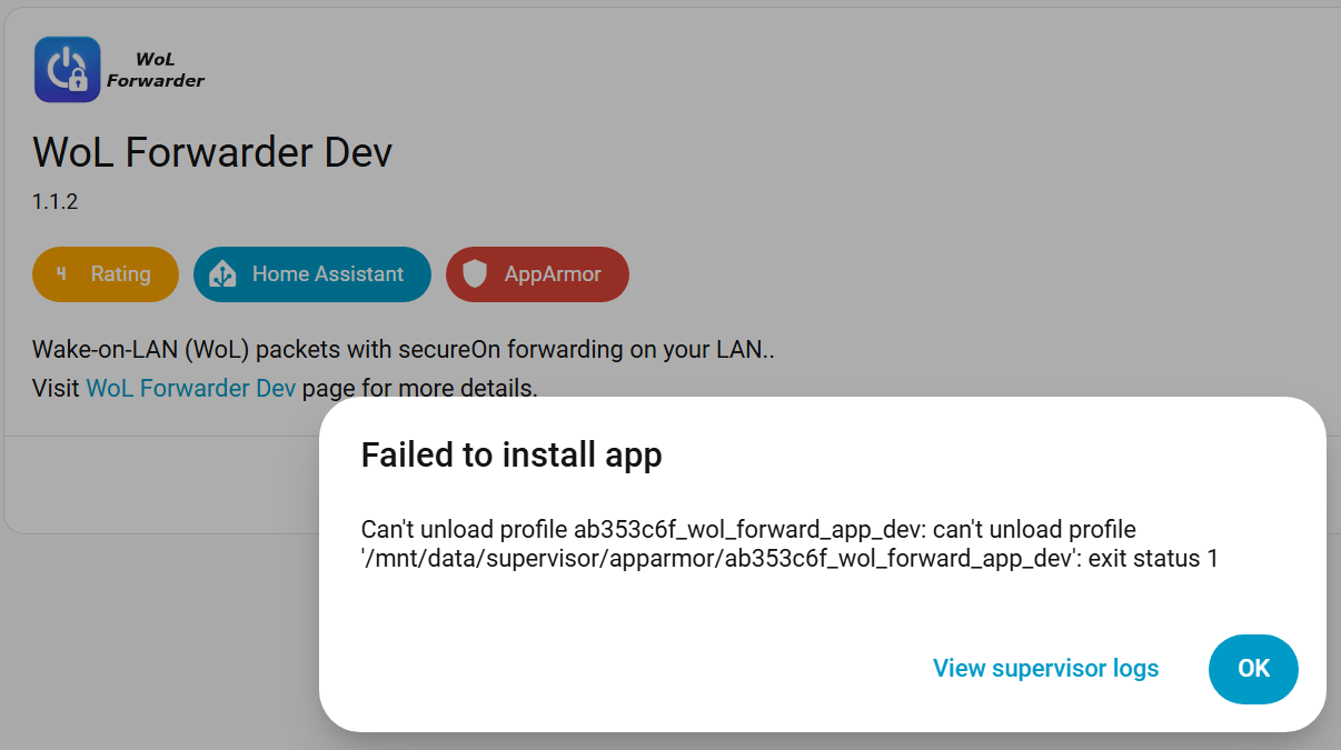

Tried to add an AppArmor.txt to my addon. Waste of time, as I only got failed to load profile errors in the supervisor log, without any clue what is the issue.
But, worse. I gave up and removed apparmor.txt form the archive. The error in supervisor log persists!!!:
Removed my repository, disabled AppArmor in the config.json file. restarted HA, and added my repository again. It all doesn’t help
Thanks for any help how to fix this

Found a very dirty way to solve it:
  • used Advanced SSH & Web Terminal to enter the supervisor app (docker exec -it hassio_supervisor bash)
  • removed the lingering profile (folder data/apparmor)
  • Exit the supervisor app.
  • rebooted the whole system
Edit: rebooting the whole system is not needed. Restarting the supervisor is enough (SSH web terminal: ha supervisor restart)
