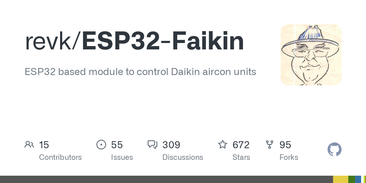

Daikin and Midea are popular here.

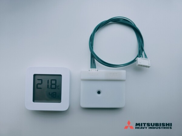

Mitsubishi Heavy Industries supports local control with their WF-RAC, but the things you can do are limited.
If you don’t want to fiddle and just want something working out of the box, go with these.
There is a separate model for both brands. It works over HTTP API and MQTT and has support for Home Assistant auto discovery. The external sensor support is a really nice feature as well.
Made in Europe. They ship worldwide.

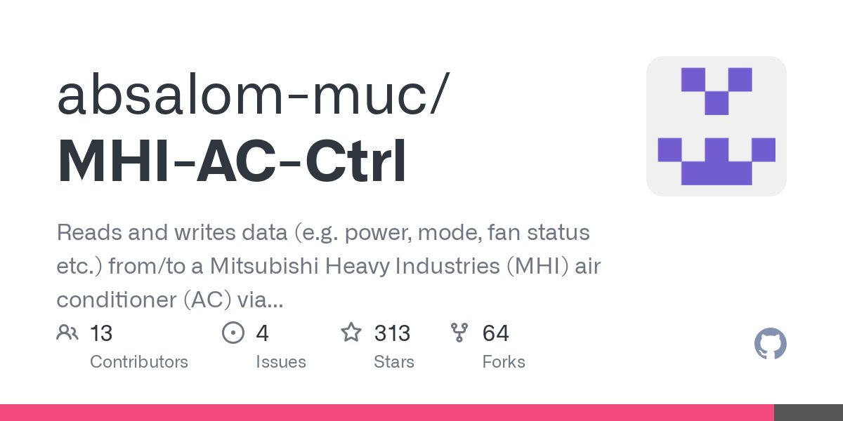

The 5 pin CNS port for MHI is supported here
But the 6 pin CNS is not compatible, so I had to stick with ir blasters for this one

If topic starter decides to go Mitsubishi Heavy Industries it is best to check beforehand if it supports WF-RAC, type number ends with an F (SRK35ZS-WF for example) or if an SC-BIKN with RC-EX3 can be used with it. In that case there is a 5 pin CNS port.
