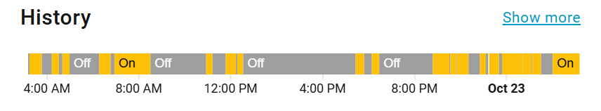

I have a esphome relay (switch.relay_1_room_1) that turns on/off based on occupancy sensor readings - pretty straightforward automation.
Now, I want to know the total time for which the relay was turned off. This will help me quantify savings. See pic below for relay on/off events over 24 hrs.
What’s the best way to know the total running “Off” time for the current month? Bear in mind, occasionally when WiFi drops, the relay becomes “Unavailable” - I wouldn’t want to include unavailable times in my calculation. I was thinking of the template sensor but I honestly have no idea where to begin since I’m not too proficient with the coding bit.
