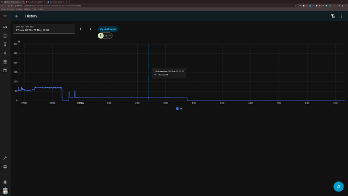

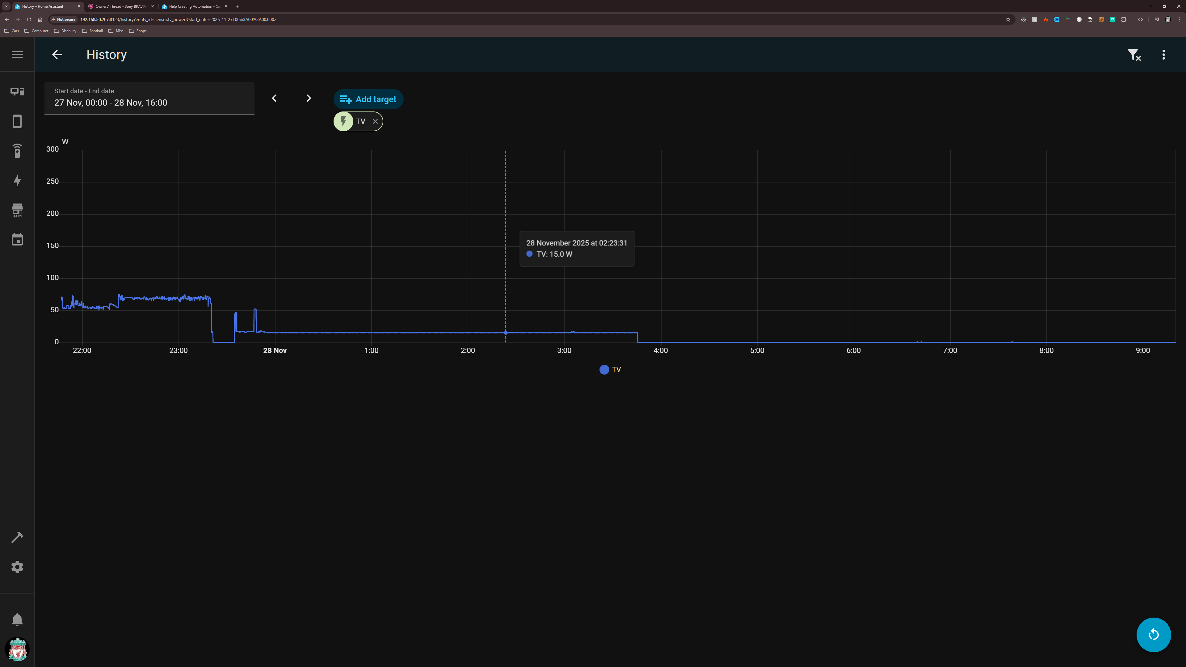

Hi, thanks for that, when I press power button to turn off tv, the power is around 15-18w for 4 hours then tv power jumps to above 40w for 6 minutes whilst tv performs a test then settles back down to around 15-18w

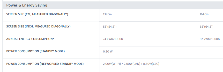

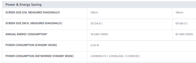

What a weird and inefficient TV you have. Not Energy Star certified, then? Are you sure your power measurement is correct?
it’s a brand new Sony Bravia 8ii so yes its energy certified, yes power levels are correct
That’s a bit above the 2W in the specs:

Whoa, back up a minute there. That Sony Bravia is an OLED, chances are it’s attempting to do the panel calibration routine and you’re interrupting it. It’s not just “a test” and it shouldn’t be interrupted.
I suggest you let it do its thing, otherwise you’ll end up with picture issues just to prevent it from using 40W for 6 minutes.
Here, I found the reference to it in their FAQ What is Panel calibration? | Sony UK
Sorry didn’t mean to sound like I was moaning or anything, I don’t interrupt the process I let it complete and thats when it returns back down to around 15-18w
