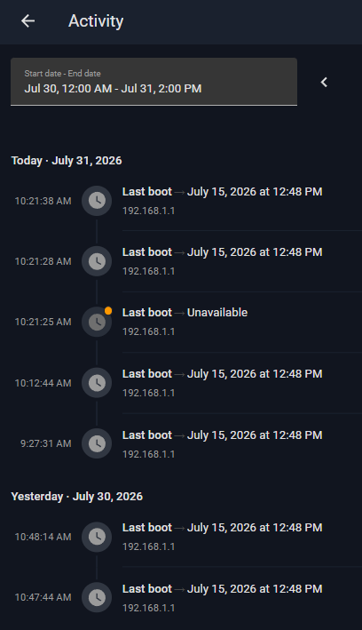

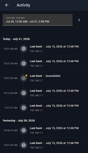

This?
That only shows 3 seconds of unavailable

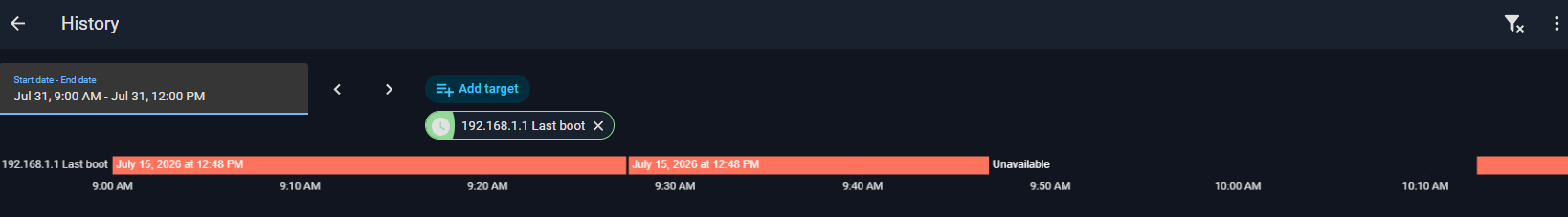

That does not match the history which shows Unavailable for about 30 minutes:

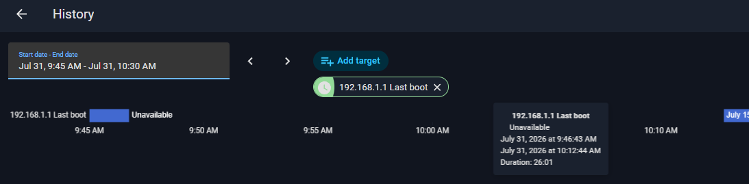

The integration and all of it’s entities were unavailable from 9:46 - 10:12 am. The integration failed to load after a reboot.

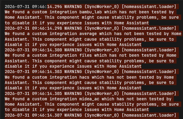

Well that would be why, the system restarted. The initial trigger was never registered to start waiting the 5 minutes.
FYI, I know the system restarted because of the log lines that you removed from your previous message. Those log lines mentioning custom integrations only appear at startup.

I restarted the system at 9:45 am and the Last Boot entity became Unavailable at 9:46:43 am after the system restarted.
