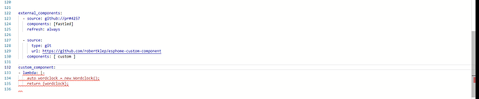

So I have an error on my ESPHome upgrade:
I need to convert a “custom” component to a external component.

external_components:
  - source: github://pr#4257
    components: [fastled]
    refresh: always

custom_component:
- lambda: |-
    auto wordclock = new Wordclock();
    return {wordclock};

I try to create an external component my self o. My GitHub but I could not figure it out. It’s just over my actual capacities.
Sadly, that’s not how it works, a custom component is completely different from an external component, it’s not just a difference in configuration.
I’ve created an external component that brings back support for custom components: GitHub - robertklep/esphome-custom-component: Brings back support for custom ESPHome components
You should only have to add some additional YAML code to get it working again (although I only created this component this morning and it’s not been very well tested yet).
Thanks Robert!! I´ll take a look!
no yet ready my friend:
My bad, I forgot to add the custom_component component in the README:
  - source:
      type: git
      url: https://github.com/robertklep/esphome-custom-component
    components: [ custom, custom_component ]
It seams to work ok!. I´ll test it at home and let you know!
Thanks my friend!! You brought my word clock alive!!
Well done!
Nice! :+1:
