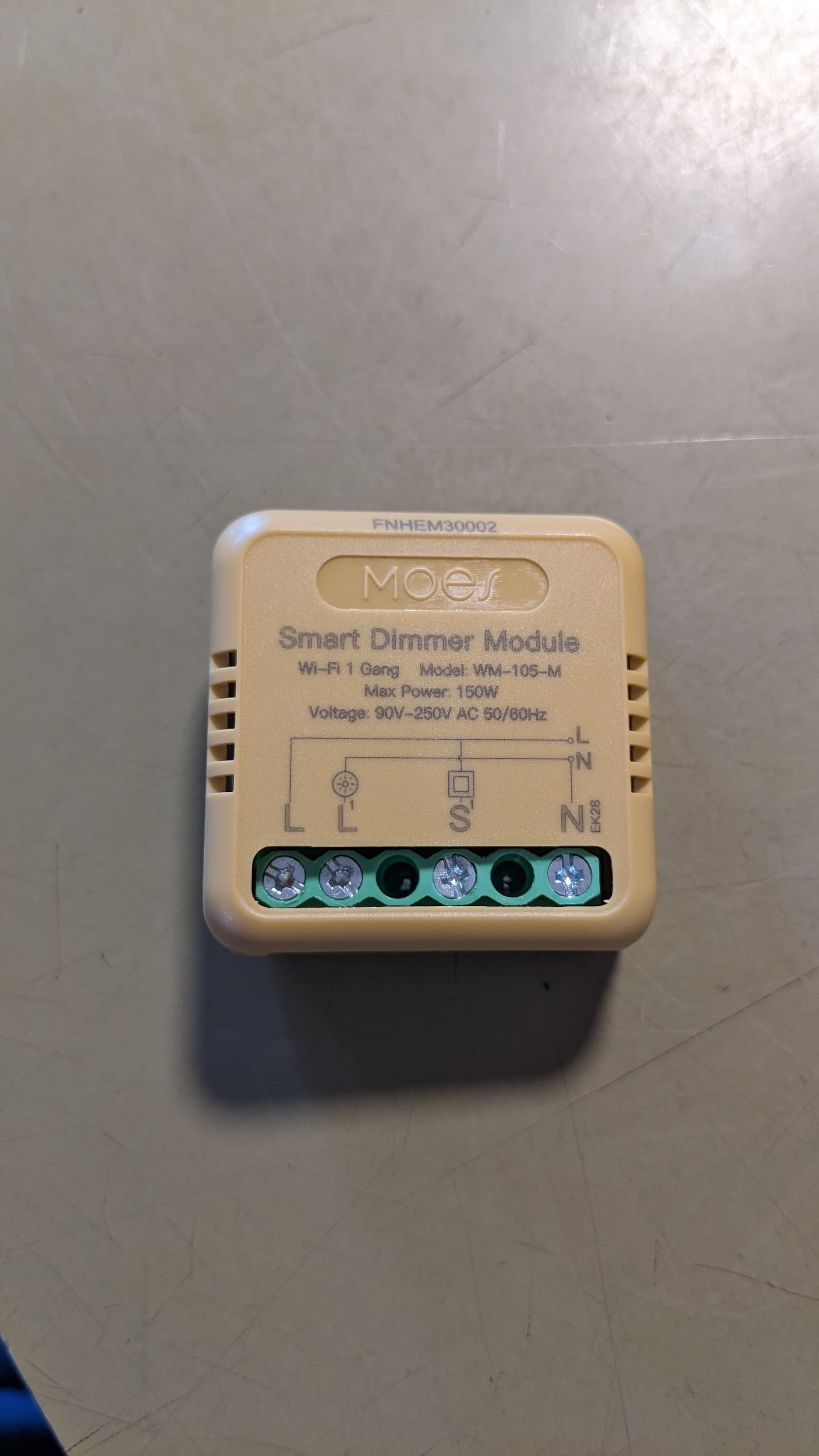

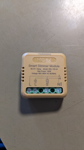

I recently got some cheap Moe’s WM-105-M dimmer modules:

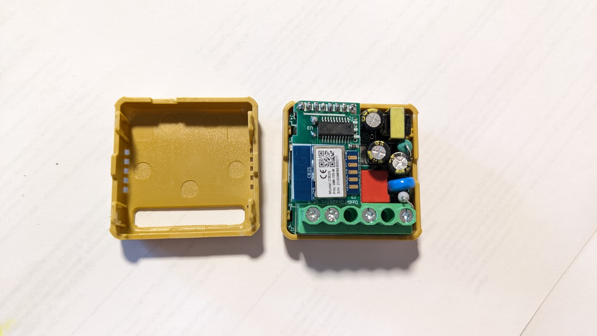

I took the case off one (bit tricky without proper tools…lol) - the module inside seems to be CB2S:

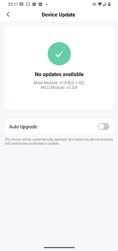

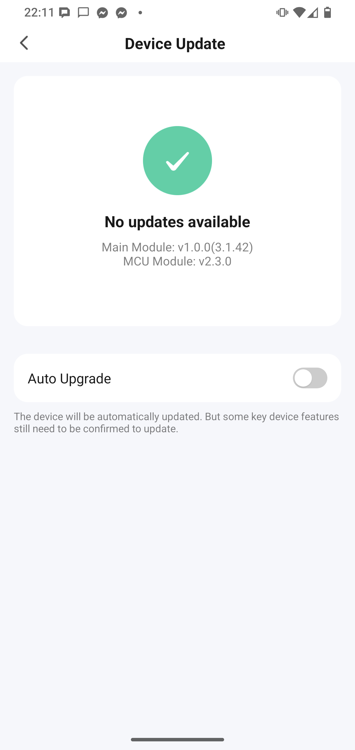

In the Tuya app, this is the version information for the module:
The tuya-cloudcutter instructions mention that you should be looking at the “Main Module” version number.
However, in my case I’m a bit confused as it says “v1.0.0(3.1.42)”.
Does the v1.0.0 mean anything at all? I assume this couldn’t be version 1.0.0, surely, right?
So can anybody confirm that the the Main Module version is actually 3.1.42 in my case? What does the v1.0.0 mean here?
