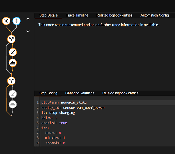

  - platform: numeric_state
    entity_id: sensor.van_moof_bw_2_power
    below: 1
    enabled: true
    for:
      hours: 0
      minutes: 1
      seconds: 0
First, below 1 for 1 minute is extreme, because it means 0, it is not less or equal in HA.
Second, can you click Open your Home Assistant instance and show your template developer tools.
And put on the left part of the screen.
{{ sensor.van_moof_bw_2_power }}
And look at the value on the right, is it a number? What is the current value like?

the thing is that the second trigger is not running. I can only see the consumption of my smartplug not the ebike.

the thing is that the second trigger never start to check if the power of the smartplug is below a certain number
I checked when the bike was 100% in the app and the smartplug doesn’t go off.
The trigger is triggered (weird sentence) only if the sensor is 0 for 1 minute.
It is not starting the automation and do the 1 minute wait.
So, yes, if the sensor is not 0 for a full minute, it will never even trigger.
To be honest I’ve never really understood the automation trace display.
The trigger is only ‘triggered’ when the condition is met so there’s nothing to show in the trace display.
Yuo need to investigate what the actual smart plug consumption is when the bike is fully charged - look at the sensor history as described above. Then set your threshold value (and time if needed) to something that will detect fully charged. Even when the bike is fully charged you are still powering the charger so the value is likely to be above zero.
