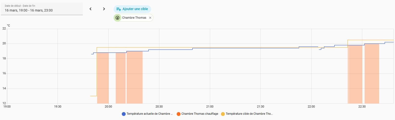

The problem: The “Chambre Thomas” thermostat switches off and on several times during heating while the target temperature has not been reached, then stops definitively below the setpoint. The room takes a long time to heat up (end of the heating loop), which makes these premature shutdowns even more problematic: once the heating stops, the temperature stops rising entirely.

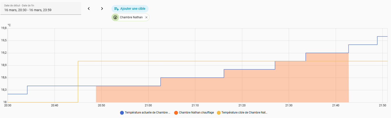

The “Chambre Nathan” thermostat works perfectly with a strictly identical config: heating stays on continuously until the setpoint is reached.

What I’ve ruled out:
  • Erratic sensor values: readings seem consistent
  • Sensor issue: I swapped the sensors between the two rooms, the problem stays on the same room
  • HA environment: tested on a fresh HA instance with only the bare minimum needed for the test, same behavior
  • Switch bouncing: the switch stays on off after shutdown

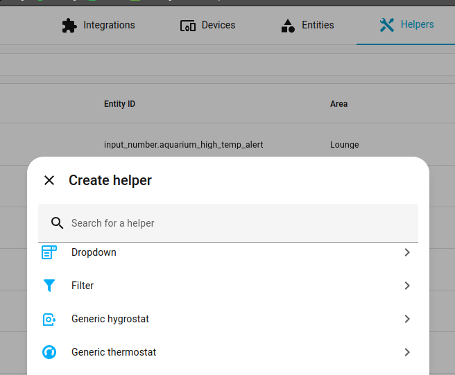

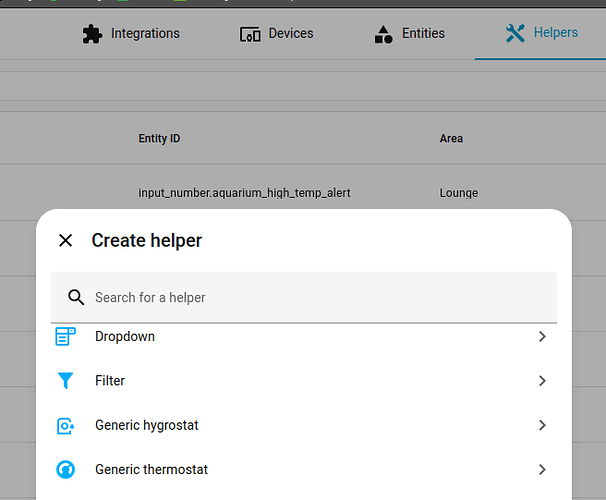

Try setting up the thermostats via the UI instead:

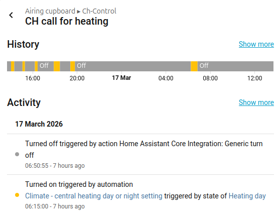

Also make sure nothing else is turning off switch.switch_vanne_thomas. Have a look at the history for that entity: you should be able to see what’s turning it off:
