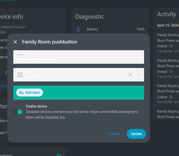

Hello - I am using a dark theme (dark_teal) and when I change the name of a device, the dialog box looks like the attached. I can barely see the white text in the almost white box. Is it possible to change the text color for just these input boxes? Or if not, is it possible to change the background color so that I can read the text? Can someone please tell me (or better, tell me how to figure out) which items in the theme need to be edited to make this change? Thanks.

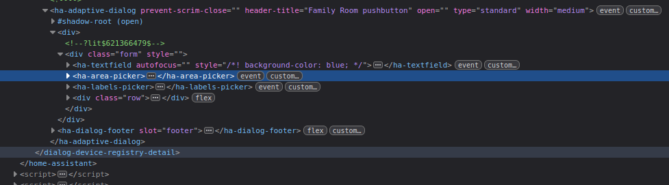

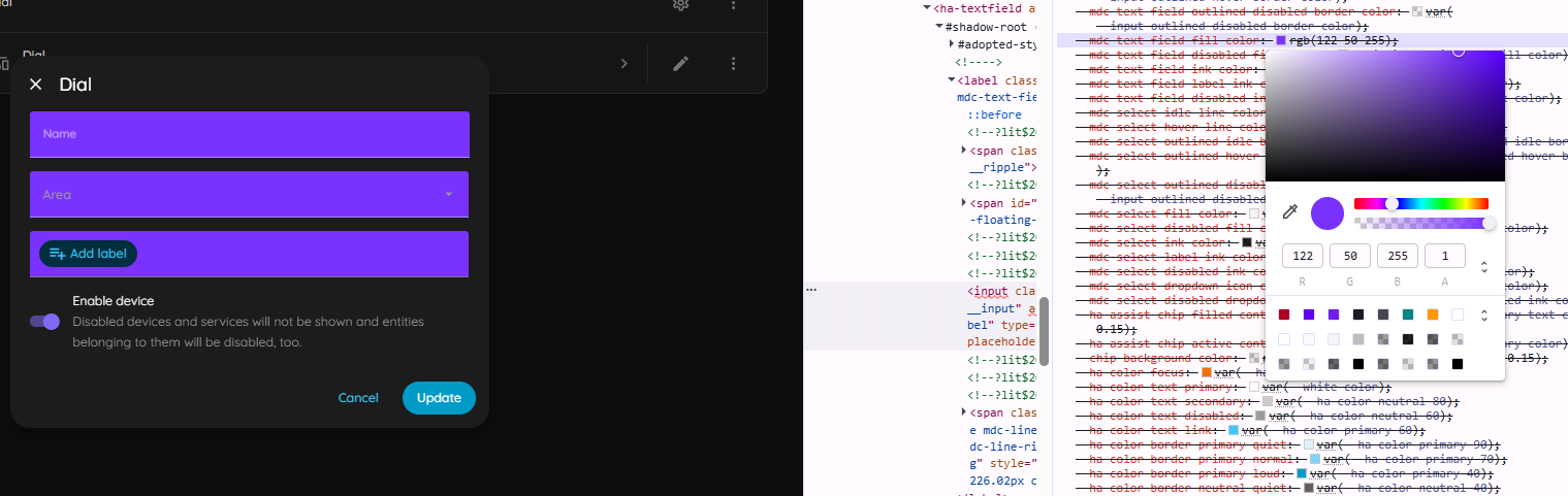

You can use developer tools in your browser of choice to select the input field html element and look at the styles it uses.
I found that the background colour for the input boxes uses --mdc-text-field-fill-color and possibly --input-fill-color.
Hopefully this helps!

I can’t find it for you unfortunately… as you saw, it worked on mine.

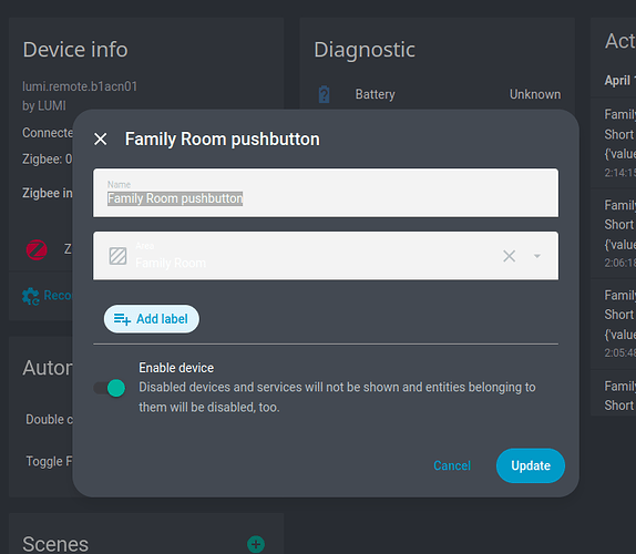

Am now on 2026.4.3 and have the same trouble as you with finding the variable. Something in my theme must cover it though, because mine isn’t funny colours!
