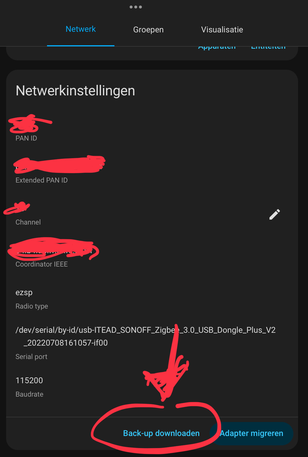

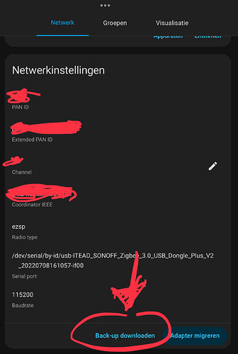

Zogbee radio’s, even the new powerful one from Nabu Casa, can’t reach very far due to the fact that Zigbee communication uses weak signals to preserve energy.
If you need long range, z-wave would be the better, but more expensive, protocol and there are other options too.
For Zigbee it is routers, routers or routers. Unless you want to set up a whole new network in a different place. Both networks will be entirely separate, each needing enough routers to reach the further away devices. The second coordinator would be near the new network, using ethernet to link to HA.Having two coordinators within USB distance is of no use.
I sure hope the backup will do, but I’m not confident unless you also backup your ZHA network settings every once in a while. I’m worries Z2M might have overwritten those if your current efforts did not get you furter.
