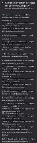

HELP just seen this on bootup and now nothing works
I really don’t know what to do here can someone help me!!

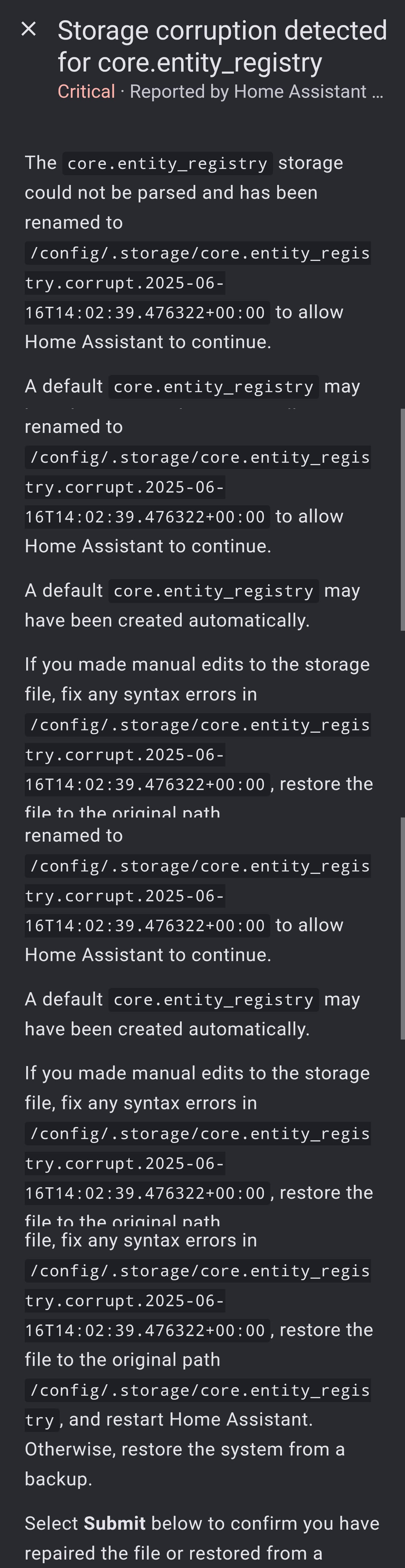

Almost at the end of your screenshot
“Storage corruption”
  1. Get a new SD card (not the cheapest you can find)
  2. Reinstall Home Assistant
  3. Restore from Backup.
Unless you did your backups on the SD that failed, you should be fine.

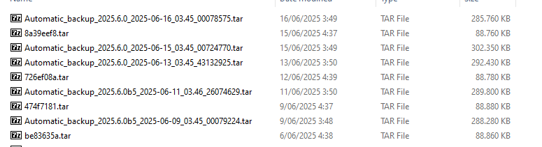

I have an old one but it’s in a VM how do I recover from that one ?
Try first with the one from 23 minutes ago.
Otherwise, the 3 dots, and download backup

Boot into the VM and find the backup. It will be a tar file, like
2025_5_3_2025_06_16_03_32.tar
Copy the tar file to a thumb drive or somewhere on your network. After reinstalling Home Assistant, you need to get this file into the /backups folder. How you get there varies depending on how you install Home Assistant.
When you install Home Assistant install the Advanced SSH & Web Terminal add-on. Then you can SSH into Home Assistant from your PC and just copy the file.

That’s not really a fair assessment of VMs. They are very reliable, easy to backup and fast to repair. In most cases, it is the hardware or a poor setup tthat causes issue.
Naming depends on what made the backup
Automatic…tar is from the new system
short names are from the google drive backup add-on
I suspect
comes from the Samba backup add-on ?
Anyway, on proxmox, I still have the VM backup if everything fails.
If you get it running again, make sure to set up automatic backups, and make sure you copy them somewhere else then your HA
Good observation. Yes, it is from my nightly Samba backup. I’ve never needed it, but it’s comforting to see it in my backups share.
