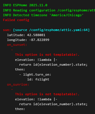

@Didgeridrew thank you very much for the code. I definitely thought it should work but apparently elevation is not templatable.
