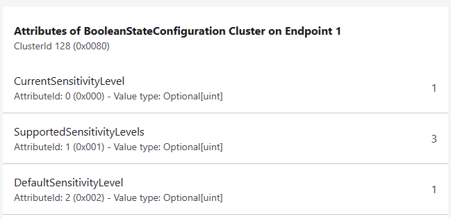

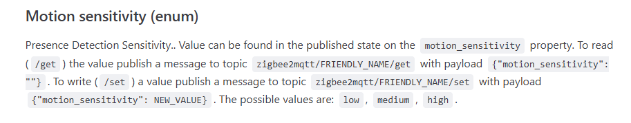

There is seemingly no way to put in custom mappings (ZHA quirks and Z2M converters) but I believe that Matter allows manufacturer specific clusters and attributes just like Zigbee. Take my Aqara FP300 as an example I can see a BooleanStateConfiguration cluster which is showing up in the Matter server but doesn’t map to any controls in HA
and I am fairly sure this would be the equivalent of
So I guess I am looking at how and where the clusters are being parsed and what decides what makes it through to HA. Is it even possible top map this across or is this problematic because it is so generic and there is no mechanism to handle that?

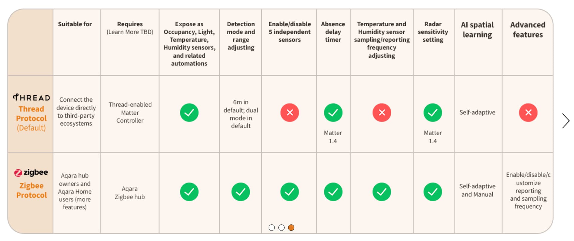

I know this doesn’t help you, but I wouldn’t recommend going on a wild goose chase to implement custom mappings on Thread for the FP300. If Aqara themselves couldn’t implement them via their own app/ matter hub, I doubt you’ll be any luckier.
Source (I swear there used to be a version of this table on their official product page, but it seems to be gone now):
For a full list of what’s missing in matter, see here. Might as well switch it to zigbee mode and call it a day.
