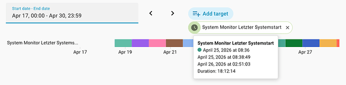

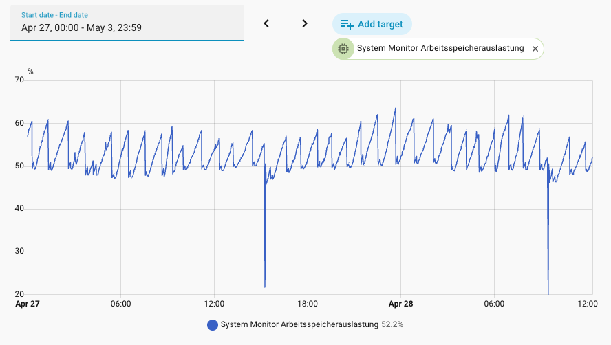

Does this look out of the ordinary to you?
The downward peaks (troughs) are around the time the system restarts.
Before I migrated to hardware (inside the vm) everything ran fine. I don’t think I added integrations after that.
Shouldn’t any log capture a restart or something?

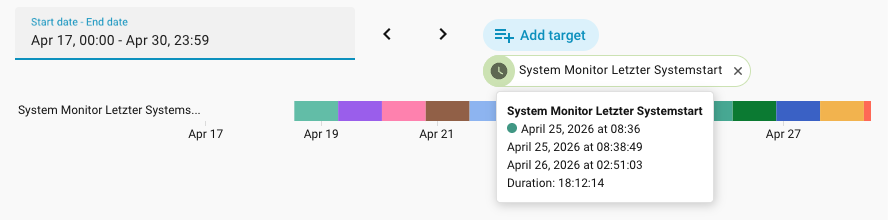

What strikes me as curious is that the system montior “time since last system start” (loosely translated) is so constant. Exactly 18 hours, 12 minutes and 10-20 seconds:
Thats very suspicious that its restarting/resetting in a pretty similiar time…how does cpu and hdd utilization look like?

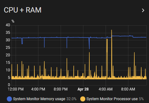

Which metrics for cpu and hdd should I post here exactly… there are a couple?
I mean any indicator but for me it is sensor.processor_use
there are several but they are mostly the same but they might give you some insights…
How much CPU load do you have? Can you make sure that CPU heat is not an issue?

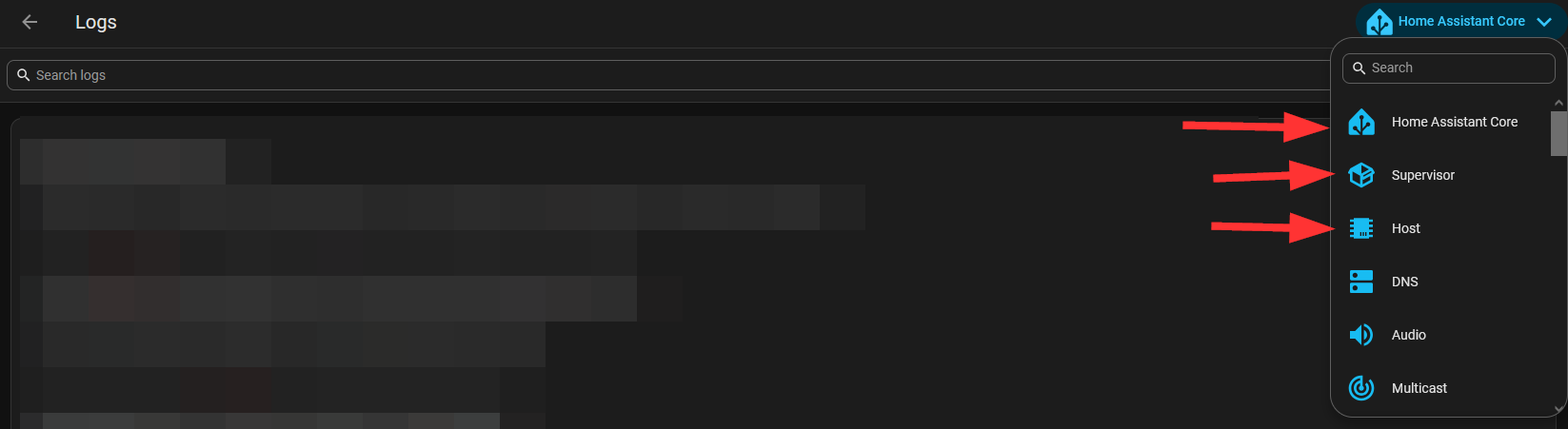

also you can browse/see logs if you dig deeper…
with this maybe you can also find out if your system restarts or so…because for me I still dont know if just the hypervisor (your HA OS) or if you whole Bare metal goes to valhalla…
