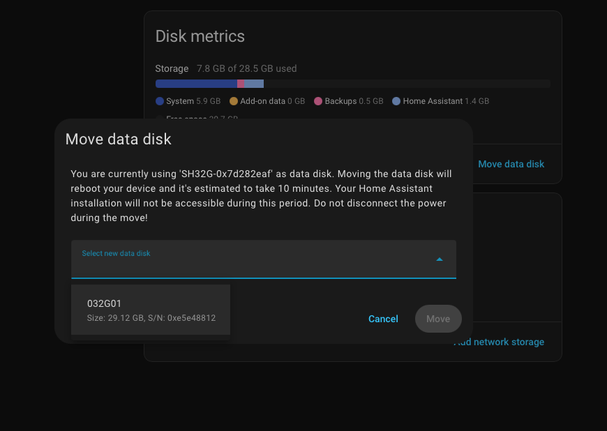

The internal eMMC (/dev/mmcblk0 ) does not appear in ha hardware info or Move data disk .
The system only shows /dev/mmcblk1 (the SD card).”

  • Checked in both the HA CLI and web UI (“Settings → System → Storage”) — the only visible disk is /dev/mmcblk1 (the 32 GB SD card).
  • The internal eMMC (/dev/mmcblk0) never appears in ha hardware info or “Move Data Disk.”

Screenshots attached show ha hardware info output — only /dev/mmcblk1 (SH32G) is present.
Based on this, it appears that the internal eMMC module has failed or become disconnected.
