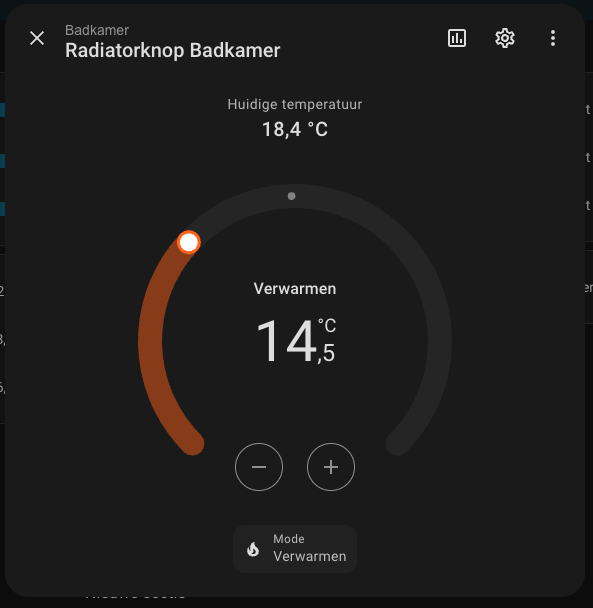

Hi there! For the last couple of days my Aqara E1 Thermostat has been heating our bathroom way beyond the target temperature (see screenshot as an example). For the life of me I can’t figure out how this is happening. It doesn’t matter how low I set the target temperature, it keeps the temperature around 18,5C. I can feel warmth coming from the radiator, so there isn’t any spillover heat from other rooms or the sun for example. The radiator is actually heating the room even though it shouldn’t.

Did you tighten it enough when you installed it.
Set the thermostat to 35 degrees or something to make sure the pin is retracted fully inside the TRV and then try and tighten the TRV again.
Thanks for the quick response. I used a wrench to install it nice and tight. So I don’t think that could be the reason. Even so, I just turned it open all the way and then closed it again. Maybe that helps?
But the problem just occurred recently. It worked fine the first couple of weeks. If it wasn’t on tight then I should have experienced the problem right from the start I guess.
If you didn’t have the thermostat set to max when you installed it then the pin was pushing on the radiator pin when you installed it.
This could lead to the TRV not being set completely and each subsequent on off movement of the pin could loosen the TRV.
It could also be batteries; they eat batteries like nothing else.
As soon as the voltage drops slightly in the batteries then it will have less muscles to push the pin.
That’s good to know. Does that mean I need to reinstall it? Or should opening it all the way be enough to do the trick?
I would open the valve max and then use the wrench to tighten the TRV.
That would be my first test
I think this fixed it. The temperature is slowly going down now. Thank you so much for your help!
