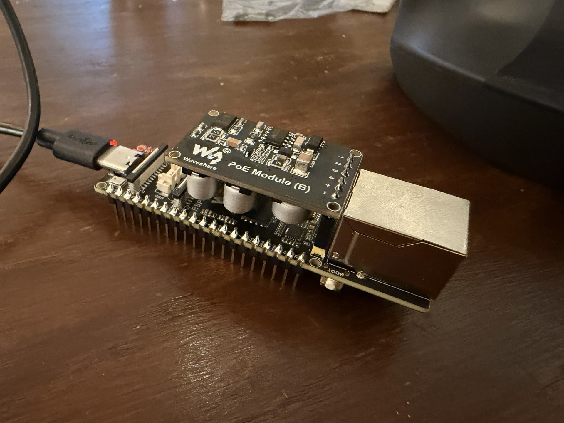

It is an ESP32-P4 Chip Revision v1.3 according to ESPConnect
This board to be exact: https://www.waveshare.com/wiki/ESP32-P4-ETH with added PoE module.
(I think this is the datasheet: Espressif Documentation)
I was naive enough to buy it and assume that it would be a good board for a simple project. But 6 hours later, trying to flash it with bare minimum config, I see that I am in way over my head with this one. And should just have used a more simple generic USB powered wifi ESP32 board… but… I was really hoping for PoE :upside_down_face:

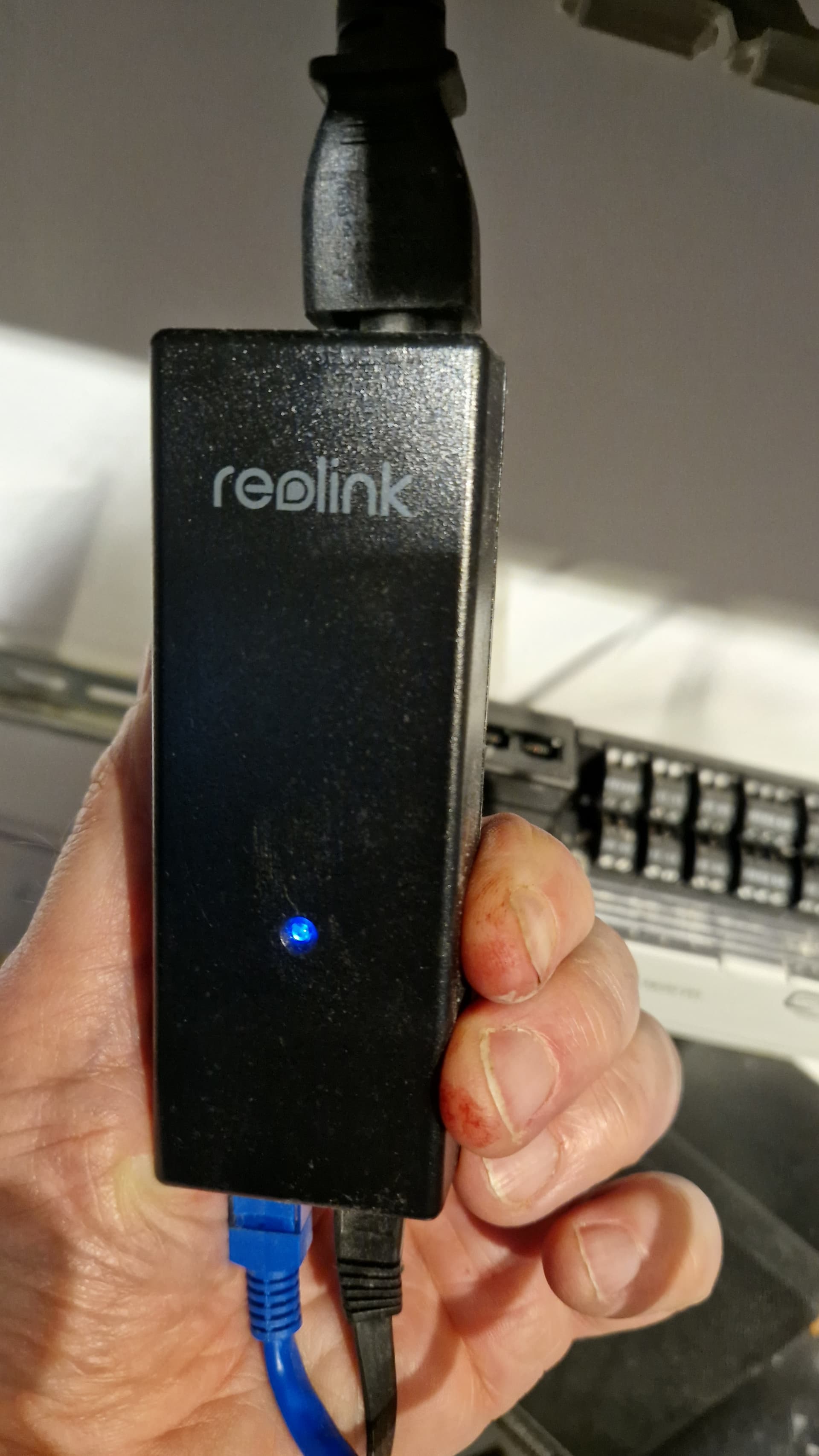

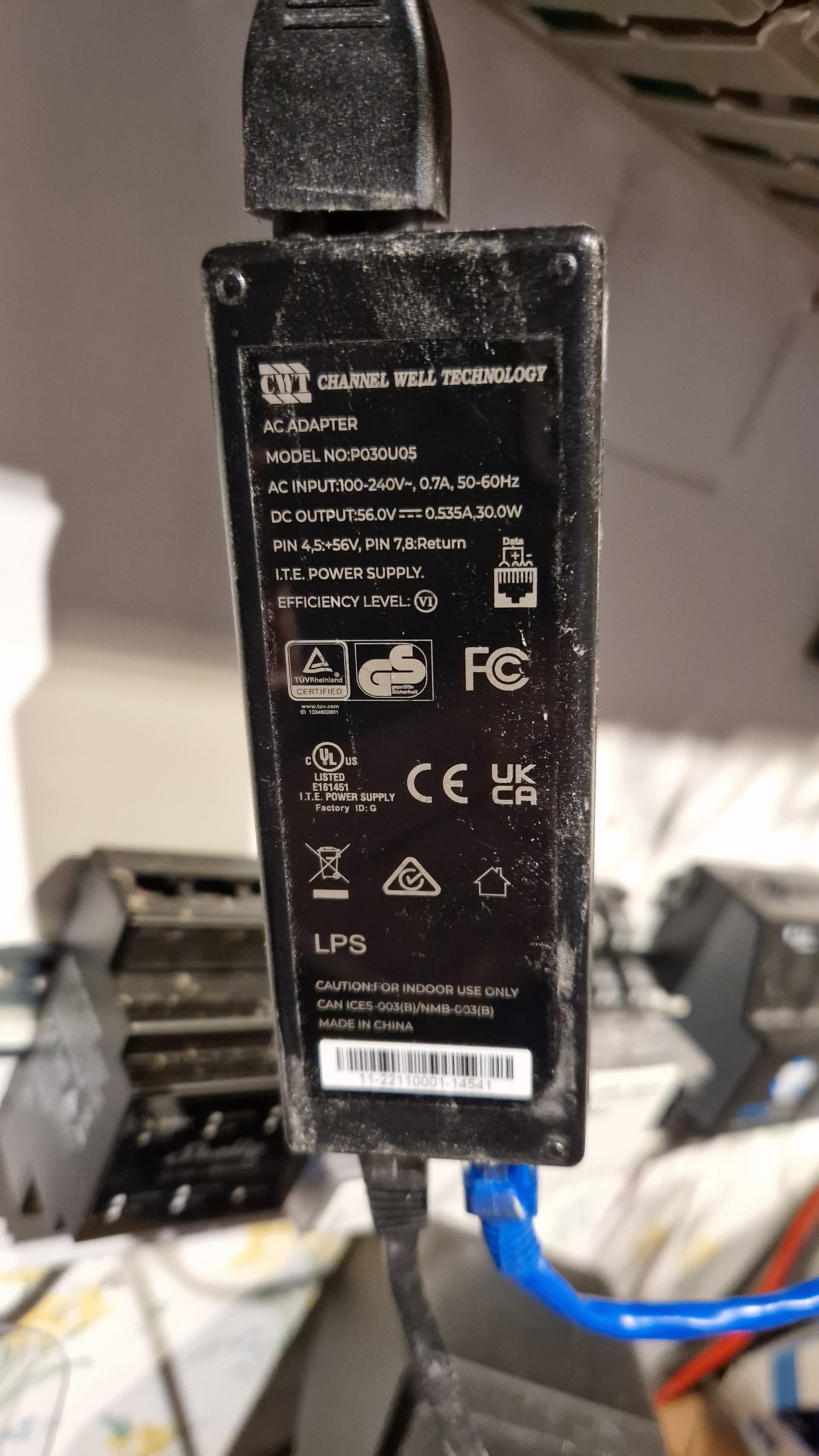

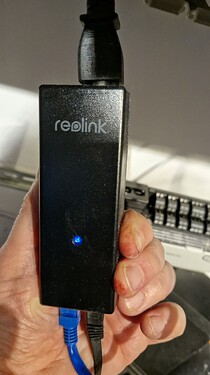

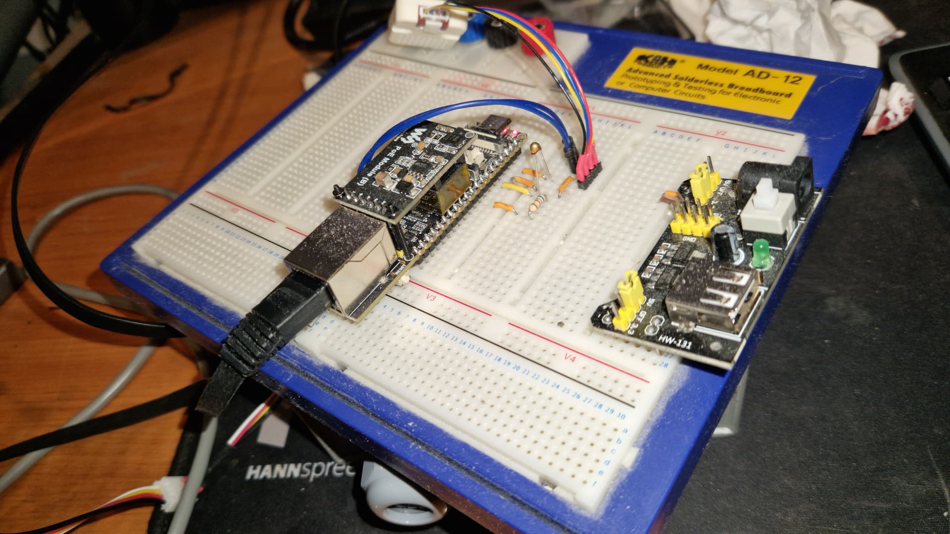

I am not sure if you have had any luck yet with your ESP32-P4-ETH, I also started down the same route with Ethernet and POE as I am trying to reduce the number of wifi connected ESPhome nodes in my system.
I had minimal issues using the code below and the board has been running ok for a few weeks with POE using a Reolink POE injector.
After the initial download through USB I have not encounterd any issues with OTA downloads through the Ethernet connection.
