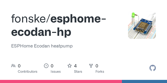

For the heatpump there is this project:
For the solar edge there is a decent integration that uses the public API or you can do it locally aswell you will need to set the setting in the inverter for this you need the solaredge app.
What remains then are the automation in home assistant.
