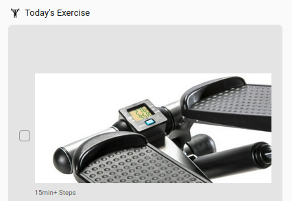

Background: I have a to-do list for my exercise routine, with a To Do for each day which contains a markup-based description. (It's actually stored in Google Tasks but I don't think that matters). I'm trying to create a markup card which shows only today's exercise, but I'm struggling to get the data out in a usable format.

I'm trying to create a sensor "today's exercise" that would have state=done or not, and attributes activity="Steps",description, and use this to populate a Markup card.

Thanks Taras, that did the trick. I had looked at the Jinja2 reference but hadn't realised there were these Home Assistant extensions.
For anyone who comes across this thread looking for how to create sensors based on todo items, here's the final code of the sensors for today's exercise. It would be nice if there were a way to avoid repeating the line set exercise_today but again that's beyond my skills.
