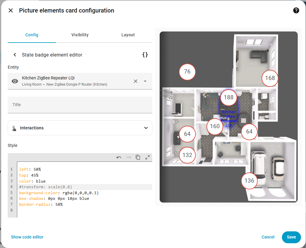

I want to keep an eye on my LQI values for my dedicated Zigbee repeaters around the house and have used the Picture Elements card overlayed with LQI entities. This works in its most basic form but I want it to be a little prettier and update it with the following:
  1. Colour coding based on link quality value (green = >120, orange between 80 and 120 and red for less than 80)
As you can see in my screenshot, my basic understanding of CSS isn’t helping me set the colour of the values and the circles. I want to keep the entity name hidden but simply change the numerical value colour as well as the white circle.

Someone mentioned a custom card for this the other day.
Don’t know whether it works, though. :grin:
Wow thanks! That is next level. But with over 100 devices I’m not sure how well it would look. But worth trying
Edit: Just read that the project shared requires Z2M.
i´m using the zigbee_flooplan card with Z2M with no problem. I have some (but not 100) devices and the manual editing needs some work in the beginning.
With other zigbee sources i guess it might work with some adjustments, didnt they discuss it in the Reddit thread?
