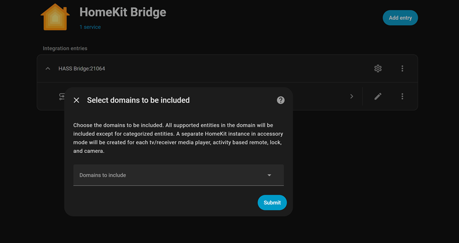

I want to setup a second home in the Home app and assign a single entity to that “home”. This is because the switch I want to control is physically in the secondary home, but it’s connected to my home assistant in my primary home via mqtt.
If I create a new instance of HomeKit Bridge in Home assistant I’m presented with this
I want only a specific button to be displayed: If I select “buttons” at this stage, it just adds all the buttons (without asking me to include or exclude specific ones), if I DON’T select anything at this stage, it will add all the entities to the new home. I also noticed that whatever the choice, the entities are unaccessible/unresponsive.
I know I can specify which domains and entity to include or exlude after the bridge has been created, but it just doesn’t have an effect.
What am I doing wrong?
