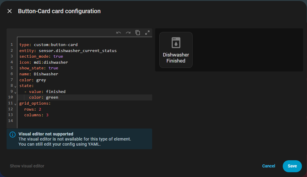

Newbie Home Assistant user here, just started using eco system a couple months ago and I love it; far better than just using HomeKit. I’m at the stage where I would like features not available on the stock install.
That said, I’m using Custom Button-Card, and can’t seem to get the icon color to change based on the state.
Screnshot below, icon is still grey, state shows as “Finished”, but icon won’t change to Green. Any help would be appreciated.

I’d say it remains ‘grey’ because
"Finished" isn't equal to "finished".
which then results in using the default color.

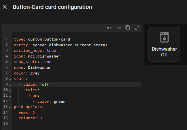

Since my dishwasher is no longer in “Finished” state, I’m testing with the “Off” and “off” state, incorporating @jeffcrum’s suggestion; and it still does not want to work for me; screenshots below. :slightly_frowning_face:
Maybe I should find another way to skin this cat. I’m just looking to have a good visual cue on my wall mounted iPad/Dashboard. Any suggestions?
